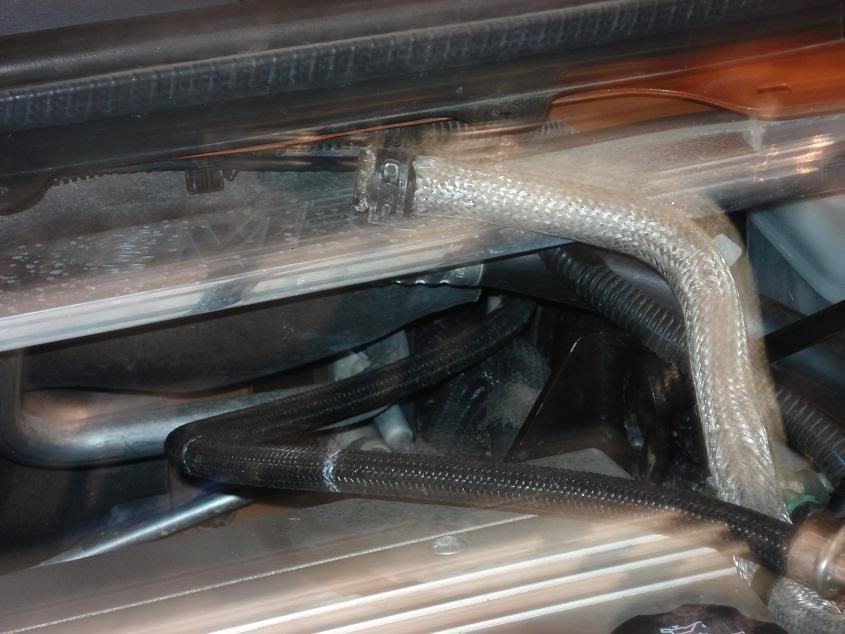

remove stuff out of your way and do whatever helps you to remember where it goes. i removed my hoses on top and my strutbar (not shown) and the heat sheild.
above hose for pvc right side.
