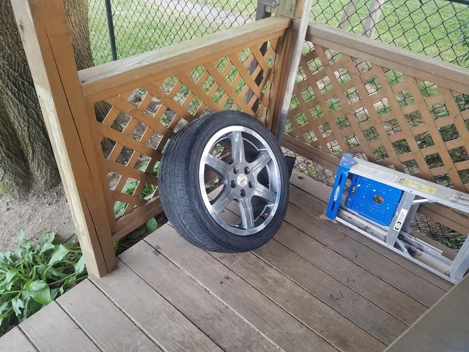

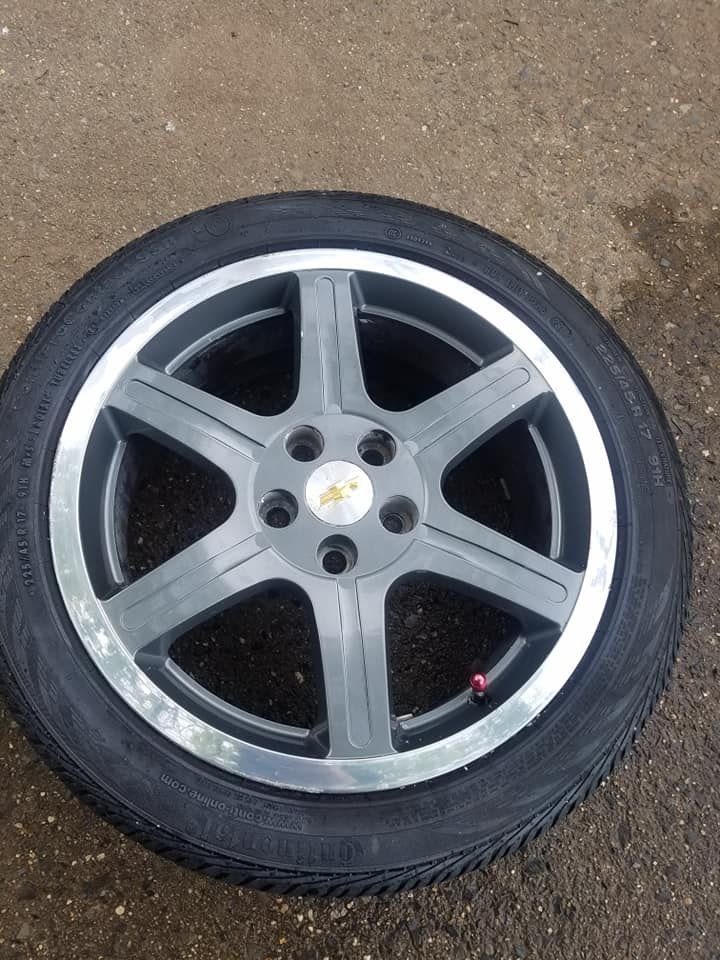

got the wheels peeled of all the plastidip that was on them. now i need to order my radials so i can get to the track and run it.
all clean. the comp wheels are gonna look good on my silver lnf

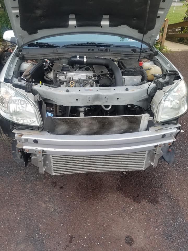

the new zzp oversized aluminium radiator
got it all installed and buttoned up
let my buddy drive it for its maiden voyage. ment alot for him to drive it and see how far it has come. he was the owner of the car before me. it was 82* in pa today and the cruising temps sat around 178-182 depending on if it were going up hills and such. run a tad cooler now then it did with the stocker.

i like it and recommend it if needing a new radiator. price is right and install isnt too bad. after struggling for a bit i found removing the intercooler helped with getting the condensor bolted back to the radiator. its a tight fit getting your hands down there.
