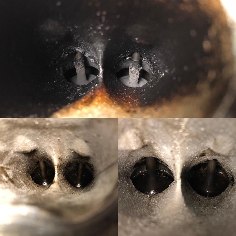

took everything apart this weekend to clean valves and install the powell air/oil seperator. was pretty happy too see how clean the inside of the motor is. the valves were a different story.
The top is obviously before we cleaned them. we used acdelco top engine cleaner and some carb cleaner. scraped it all off with picks and tooth brushes. Thanks to joe aka ThePanduuh for the help.

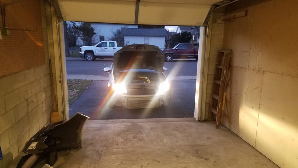

Tonight december 24th i finished it up and started her for the first time. runs great. now i need to get her retuned.
everything all finished up. very tedious but rewarding job.

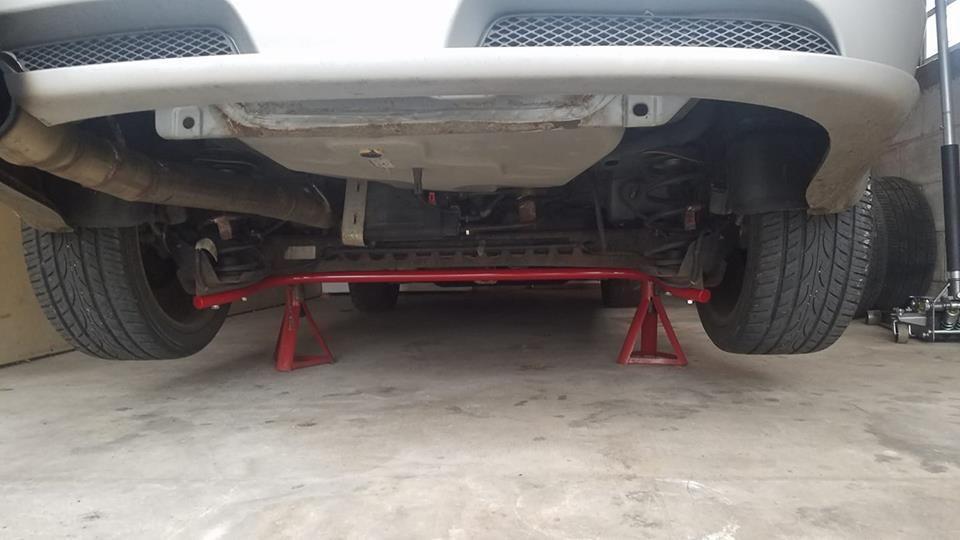

installed the ottp rear sway bar today and got alot done on my daily as well. car feels alot more planted in corners. now i need to replace all my shocks and struts.
