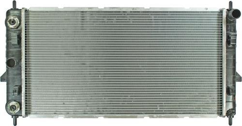

Anybody have ZZP's radiator for they're LNF?
Apparently on the bottom of the stock one I have, the plastic "pins" have snapped off so it doesn't pass safety. I've asked around and I can't figure out what's actually missing. The rubber bushings are there and the rad doesn't move so just wondering if ZZP's rad has these pins or supports or whatever they're called...

The little pins sticking out of the bottom of the sidetanks are what they're talking about. I don't have the zzp radiator, but ANY bolt in style rad for this car should have them.

without those pins the rad isnt securely mounted to the car

i know here in canada it wouldnt pass a vehicle inspection if the pins are missing off the bottom in theory the rad could in theory fall out.

This is what more typically happens to the pins...
Here's what I got when my stock one broke:

Yes the zzp rad has them, they are the bottom mounting pegs, without them Ur rad will flop around and have no support on bottom

Plastic is ****! It wouldnt cost much more if gm Wouldnt overcharge by 1000% . plastic is a hazard. Those pins breaking can rip a hole in the rad and there goes ur coolant. Its happened. Luckily mine didn't but I ran into someone who it did happen to.
