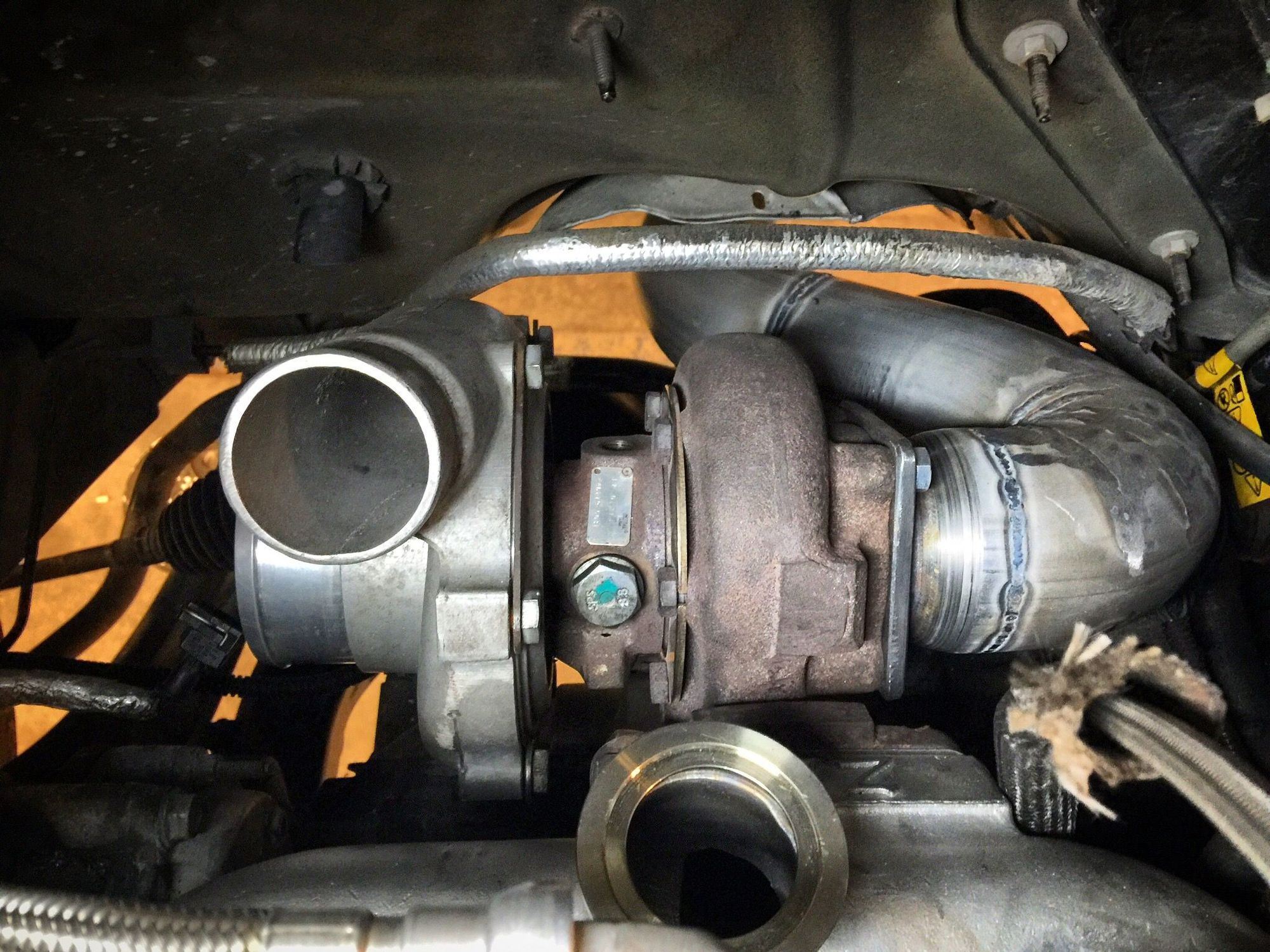

Yeah it's a t31. But 4 bolt compressor housing
https://cimg2.ibsrv.net/gimg/www.cob...19b2043c4.jpeg

A 257 is a t3 flange and I'm waiting for him to dyno but I'm expecting close to 500. I'm in :ca: too so I know your fuel issues but 94 isn't that bad compared to :usa:'s 91
