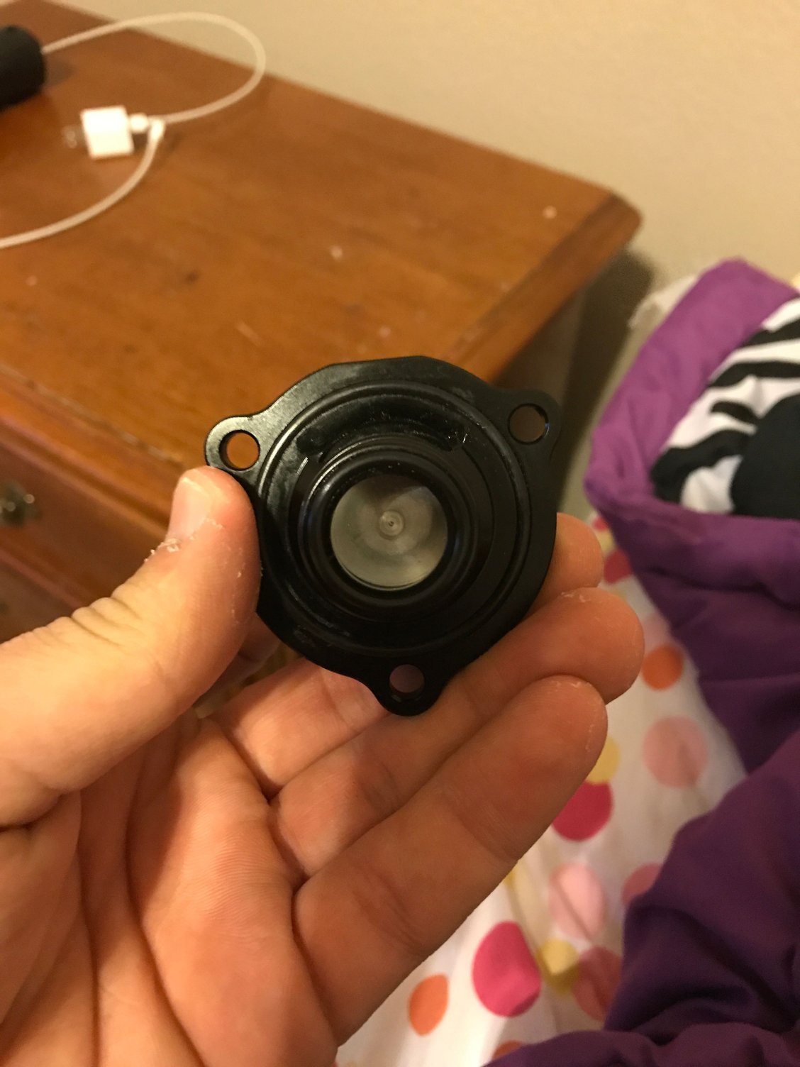

are these already on the car? I cant find much info on the turbosmart dual port. is it a replacement for the stock BPV or is it a typical BOV?
only intake hard pipe and intercooler were on there. Everything else is sitting around. What's everyone's opinion on the zzp catted dp??
Idk why but it shows up back wards
Direct replacement from stock bpv.
