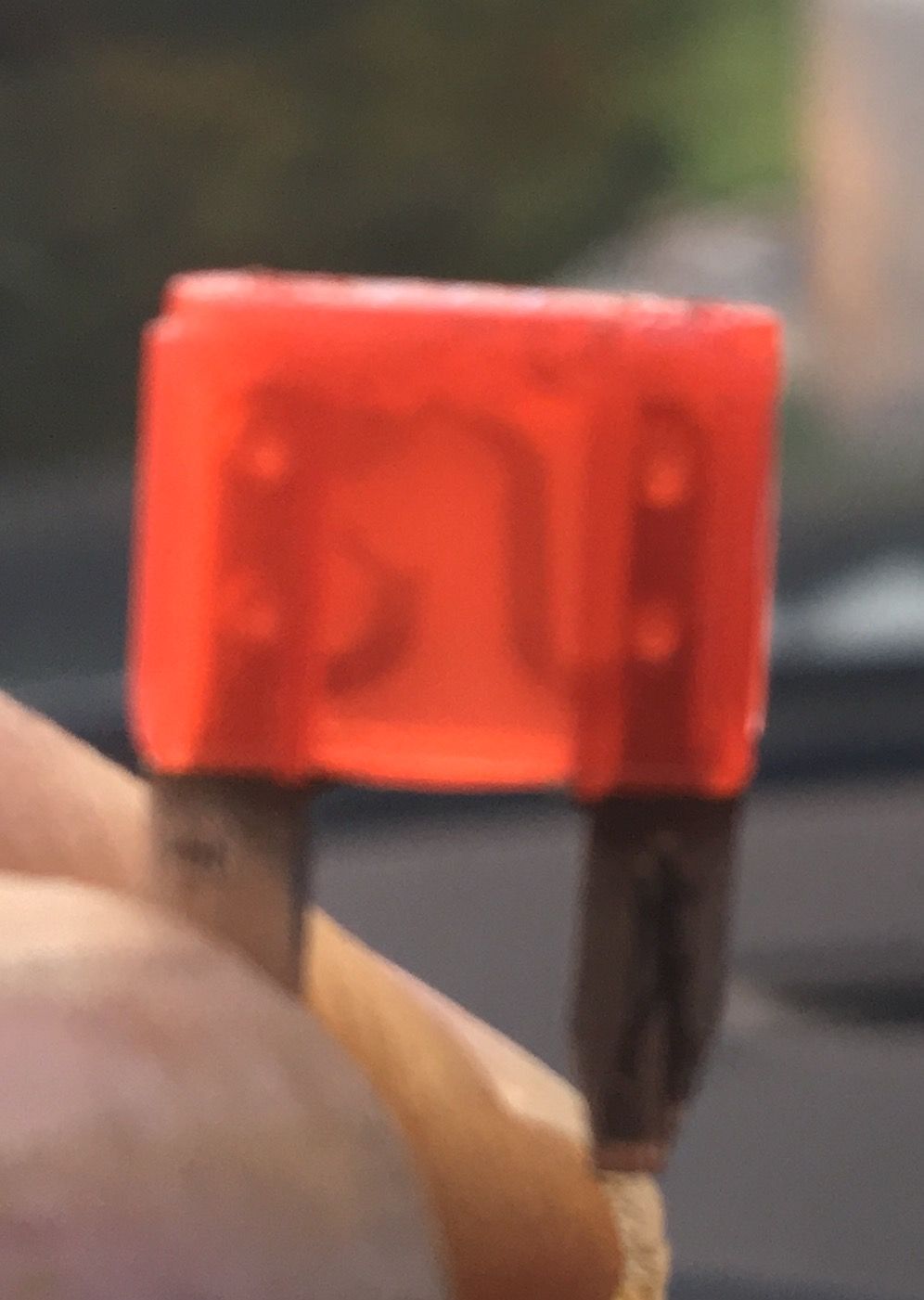

https://cimg6.ibsrv.net/gimg/www.cob...a30a148f3.jpeg Found one blown fuse, replaced it and sure enough, all my codes went away! Well, except the CPS code but that's been there for 3 years :D https://cimg2.ibsrv.net/gimg/www.cob...757f64738b.png |
Yay. Glad you found it!
Over the winter you may want to trace that harness back and make sure you don't have a bare wire somewhere that intermittently grounds, causing the fuse to blow. |
I did find some superficial wire damage and I think I know what caused it. When I broke down the last time, I found my coil cover had come completely loose and had been sliding around under the hood. This is an aluminum piece with fairly sharp edges. The insulation on the far right coil was damaged as well as that on the two cam sensors/solenoids/whatevertheyare on the same side. I'll be sure to re-insulate everything very well.
