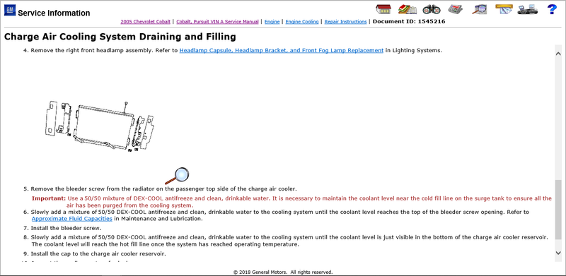

2006 ss cobalt 2.0 supercharged:
what type of fluid is used in the supercharger system?
should the fluid level be visible below cap, in fill neck?

The water to air cooling system uses 50/50 dexcool.
