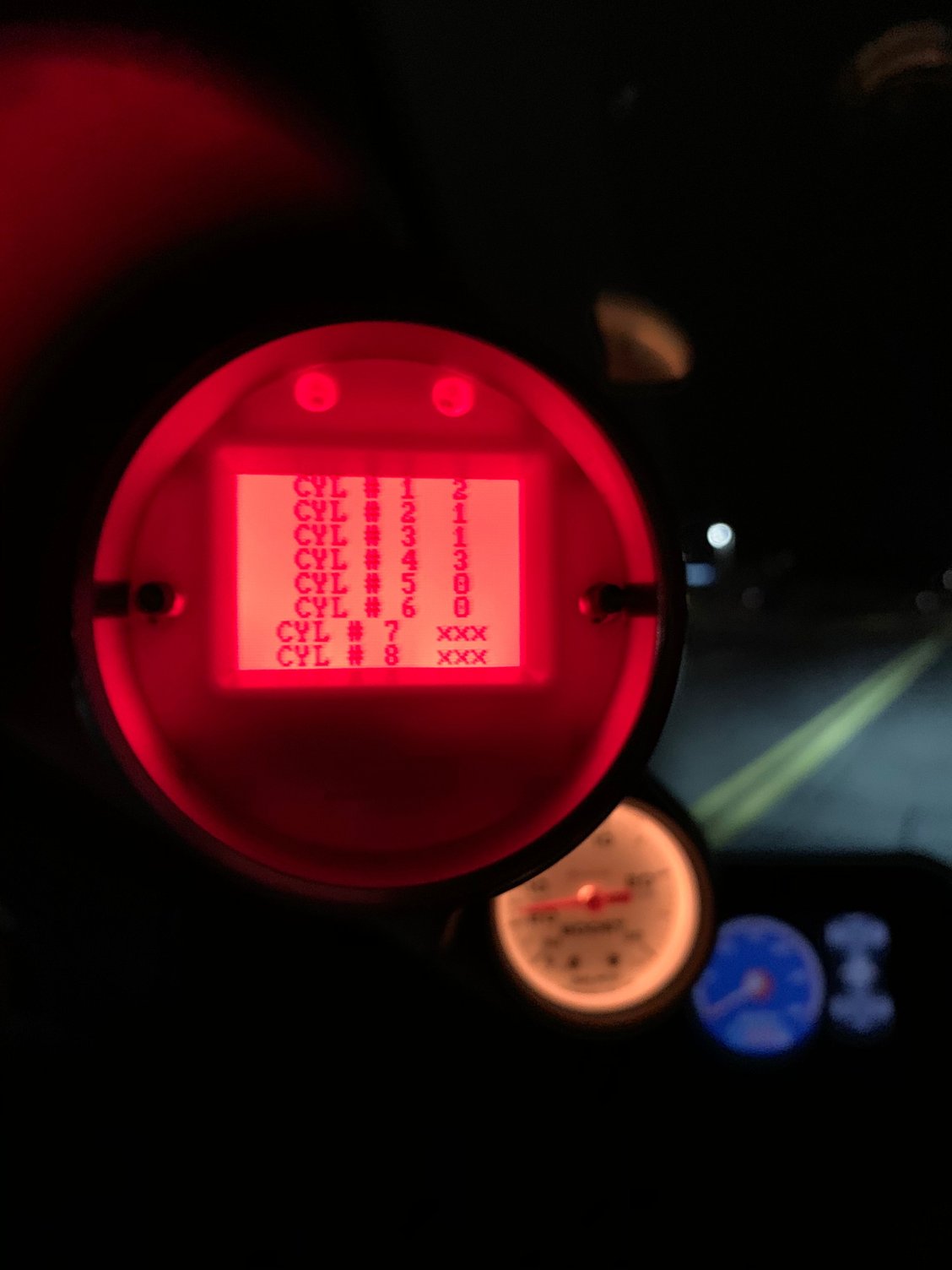

Hey guys, couldn’t find anything on this with the search bar for random misfires. But I’m currently tuned on my built LDK long block. Just changed the coil packs/spark plugs and the car keeps getting random misfires was specifically on CYL1 would go up to 10 misfires on cold start idle then when I start driving it would basically go away. Switched over to NGK LFR6A plugs 0.28 gap. Now it’s not misfiring as much on cyl 1 but now scatters through all 4 cylinders only showing 1-2 misfires. Not sure why anymore. Car recently got a smoke test, compression test and leak down. Passed all tests.
car has MAF relocate, HKS BOV, exhaust, short ram intake, upgraded intercooler, charge pipes, upgraded valve springs cams and OE fuel injectors.
any one have any thought what else I can look into so I can get rid of this misfire? Seems like under wot there is 0 misfire and no spark blowout.
