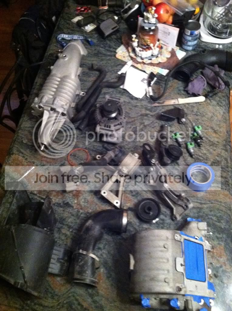

So it begins the long and much wanted Supercharger kit. Everything will be arriving on Monday. but for now here are some of the things that i have collected for the build. Forgive the shittyy iPhone quality pictures ill be using my real camera for the build pictures.

Update just got my Supercharger kit in today just need to get some bolts, Intercooler pump, lsj windshield washer tank, brake booster line and lsj throttle body

very nice, i dont see a heat exchanger though. what one are you gonna be running?

I'm running the stock one it came with the kit. he had to find a box big enough to ship it in he dident want it to get damaged. for your build you are using the lsj TB right?

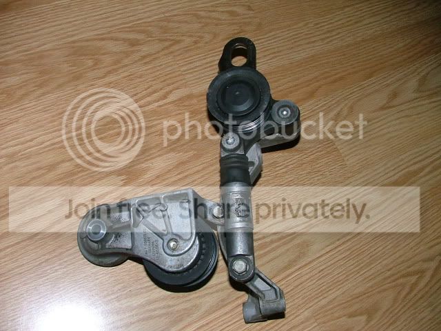

Thanks man i was looking at your build and I saw something that another member posted with a pic of the alt and something else attached to it im not sure what it is im going to attach a pic maybe you can help me out

nice thank you so much and here is whjat i dont have
the thing attached to the left of the bracket what is that?
Old Nov 14, 2011 | 10:45 PM
drumrush's Avatar
Joined: 02-23-11
Posts: 3,446
thats the lsj idler pulley, it replaces the stock l61 tensioner
ahh ok so i have to find me one of them then

do you have all the gaskets for everything as well? i also dont see the lsj radiator hose in that picture

the supercharger gasket to the IM is mounted on the IM the IM to the block I have and the LSJ TB to Supercharger is the orange on in the pic. I have to get the upper radiator hose because the guy I bought it form did a swap so he still needed some parts.I'm going over everything now and making a list of everything I need
