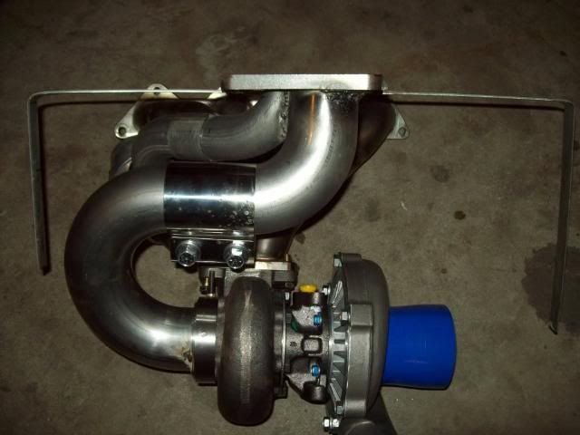

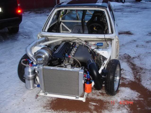

FLASHING UPDATE
communicated with BTF last night.
We are both following this guy from Finland using his BMW motor. I am not really sure what size his small turbo is...but his big turbo is GT4788r. He is getting TOO much back pressure, and the COMPOUND Turbo geniuses, think that the GT4788 (although already a big turbo)....is too small for his set-up. He is getting 40psi of back pressure with 28psi
So BTF was recommending me to upgrade the GT4094r turbo to a T6 based turbo. I'm still undecided. I dont want that big of a turbo........I was hoping if we can use GT42 with the biggest AR available. So we'll see what happens.......
Anyways, here are some photos of the guy from Finland

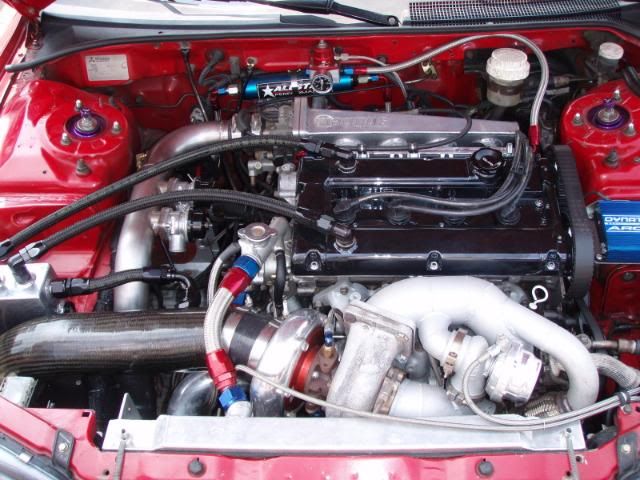

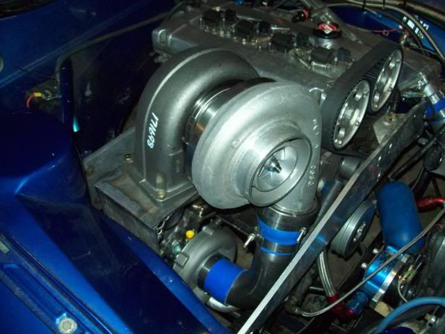

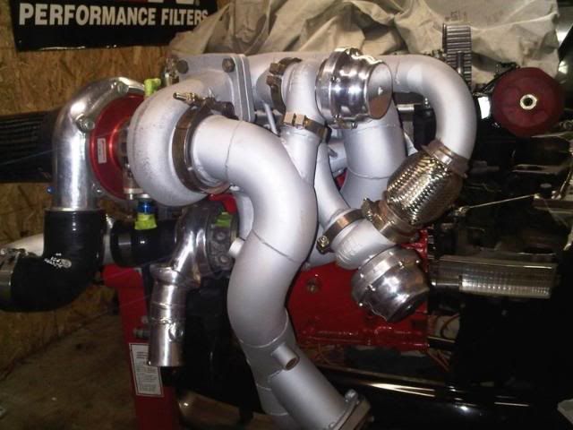

A couple of DSM guys who have very succesful compound turbo set-up:
here is the set-up of Kevin
and the set-up of another DSM owner Paul
DSM guys are off the hook! They know what they're doing
