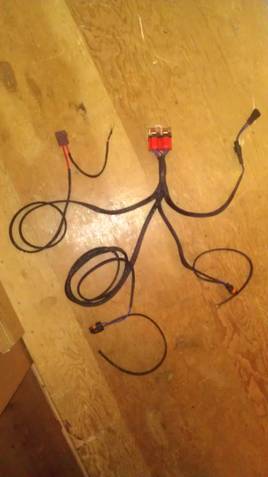

http://Name:  tn8.jpg
Plug in upper right corner is one I am wondering about

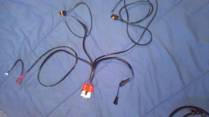

http://Name:  tn6.jpg
http://Name:  tn5.jpg

You have the wrong harness. That is a H11 Relay Harness.
I believe i have a H7 Morimoto Harness if not I have a standard relay harness that will work.

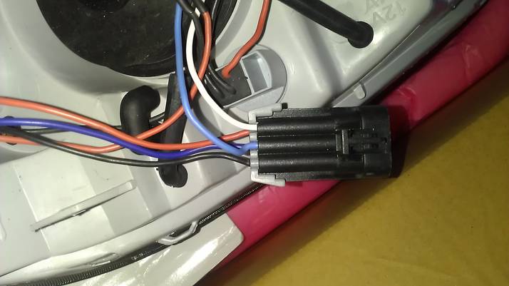

http://Name:  tn9.jpg
Would either one of these plugged into the end in place of the H11 make it a H7 Relay Harness? If so where would the wire or plug connect?

unplug the 9006 to h11 adapter and plug in the 9006 to h7 adapter. the top wire in your picture.
