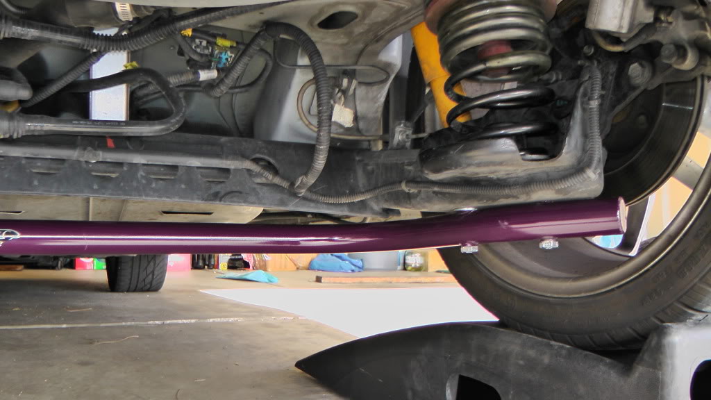

XXX rear bar - Koni adjustable shocks:
The various rear bars I've used over time:

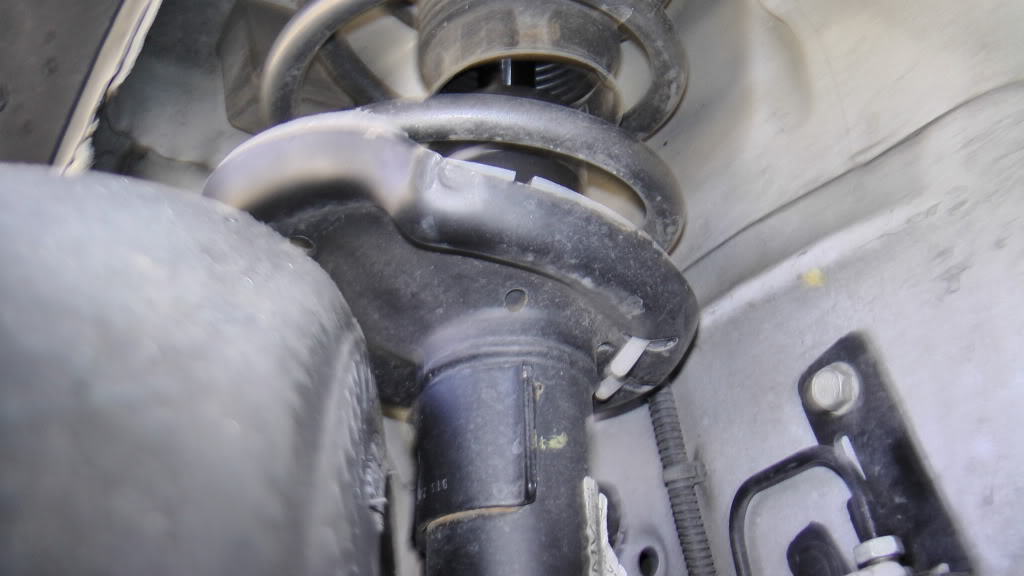

Front struts and rear springs -- Eiback coilover springs:
Name:  GroundControlkitEibachSprings700lbfronts-650lbrearsKonistrutcartridgesBGcamberplatesmod.jpg

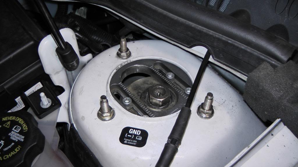

Camber plates:

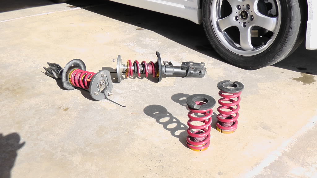

Various springs:

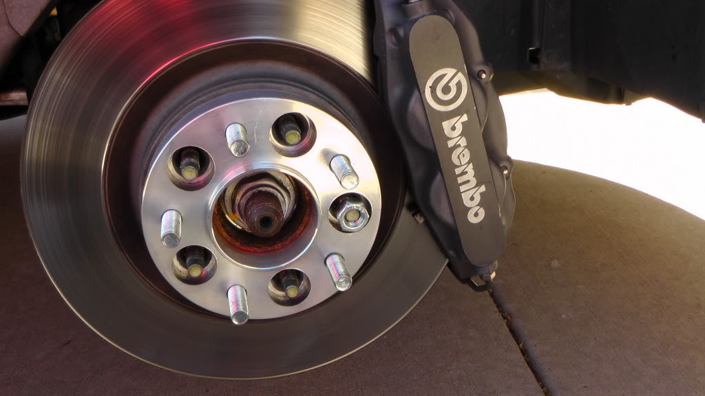

Custom made wheel adapter -- 5 x 110 inner, 5 x 114 outer -- both use the stock lugnuts:

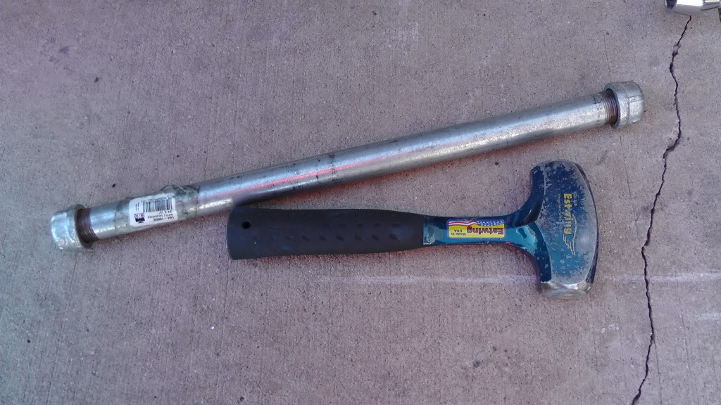

Fender modifying tools and fender mods:

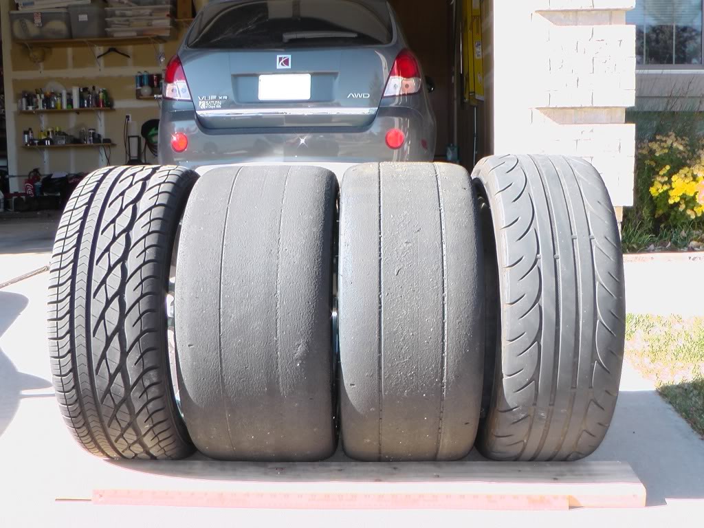

Tires -- Left to right -- stock 18", Hoosier 285/30 x 18, Hoosier 255/35 x 18, 245 x 17s -- all work:
Name:  4Tires-LtoR-225x40x18stockwheeltire285x30x18Hoosier255x35x18Hoosier245x45x17HankookR2S.jpg

The front struts are stock struts I cut and installed Koni adjustable cartridges in them. I modified a set of camber plates to work on my car with Konis.
I originally bought my spring kit from Ground Control (they no longer make the Cobalt kit -- who know, a phone call might work) and they came with Eibachs. I subsequently bought a variety of Eibachs -- various weights and lengths (the Ground Control kit came with 8" rear springs and 6' x 150 lb front springs) as I experimented over time. I now have quite a few different spring weights and I run 6" or 7" rear springs rather then the original 8" rears. The way coilover springs rate is lbs/inch of compression -- Eibachs are linear not progressive springs -- so with a 450lb spring, it takes 450 lbs of load for each inch of compression -- pretty stiff.
My car is lowered to drop the CG, not for looks, and it takes much stiffer springs to keep the body off the tires under turning load (I'll drag up some photos of my local competition to give you some examples).
The springs don't come out unless you unbolt the rear shocks.
Eibachs and other brands of coilover springs can be bought at reasonable prices online.
HP isn't important -- turning and stopping are much more important. I can spin both 285 Hoosiers (hot) in 1st gear and I can light them up again in a corner in 2nd -- throttle control is more important than HP.
When I autocross, I disconnect the front sway bar entirely by removing one connector, I'm running very stiff springs and more negative camber, and it works best -- the least tire spin the the front sticks best. At speed, at the edge, the car will oversteer slightly in a corner and will definitely oversteer under heavy braking while turning (sounds like an old turbo Porche).
