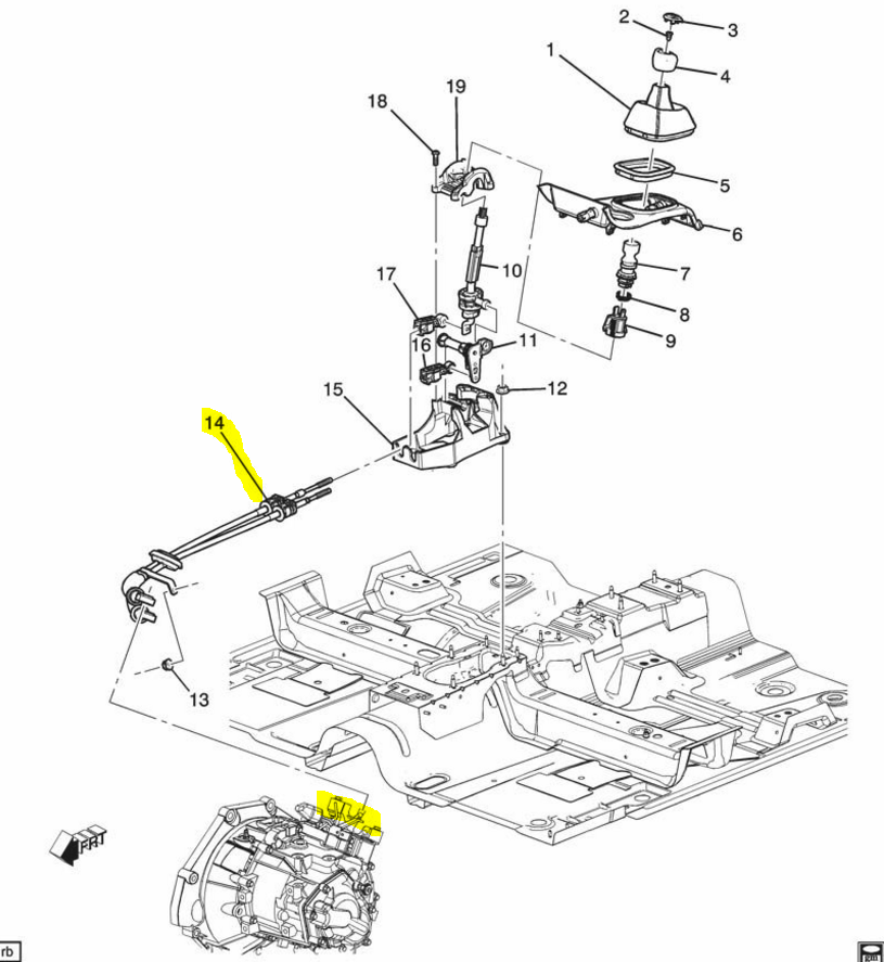

TurboFour Jan 18, 2016 08:37 PM
You can get to them through the interior to pour stuff into the cables I suppose.
I have the service manual if you want to know how to replace them (which does require getting under the car).
https://cimg0.ibsrv.net/gimg/www.cob...9ad111748a.png

Issue
Shifter is hard to move or sticks in cold weather. The shift control cables can malfunction, allowing debris and moisture to enter the shift control cables.
See the figure below for the location of the shift control cable highlighted in yellow (14).
https://cimg0.ibsrv.net/gimg/www.cob...7192b78255.jpg
Resolution
Replace the shift control cables.

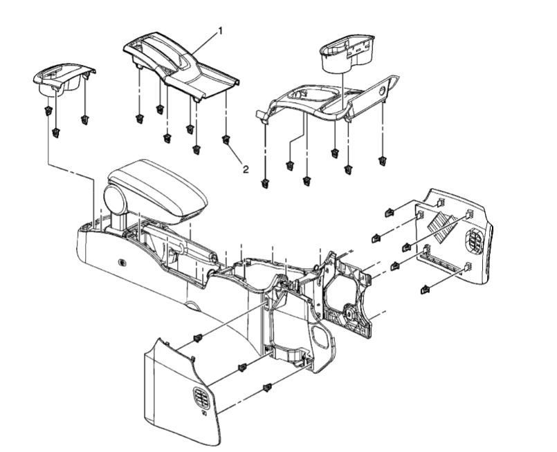

Service Instructions
Required Tools:
Metric 3/8 in Socket Set
How to remove the center console:
Step 1: Remove all the center console panels shown in the figure below.
https://cimg2.ibsrv.net/gimg/www.cob...c551fa2f89.jpg
Step 2: Remove all the screws shown in the figure below.
https://cimg0.ibsrv.net/gimg/www.cob...114c2bd614.jpg
