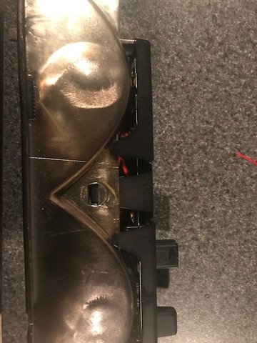

Now here is where we need the lighter. Grab the chrome housing and go to the three holes in back. The side that has the little peg sticking out is the side we need to make a slit into for the wiring. I just used the lighter to heat up the plastic and then made slits in it with my knife. Then I took a pliers and pulled the plastic out making a nice slit. You can also use a drill but this was just as easy.

Then, feed the wires through the hole you made the slit in, and line it up in the housing. The tapering edges on the LED board meet almost perfectly with the edges on the housing, making it easy to center. Once you have it in place, press down firmly to attach it to the hosing. Should look like this now:
Here comes the only "hard" part of the whole job, and that is soldering. The way the Cobalt board is made is super simple. There is no actual wires. It's one big metal board that goes to each bulb. One side is negative, one is positive. Now go to the other side and check which pin goes to the negative part on the board and which goes to the positive. It should be that the left (negative) leads to the top and right (positive) leads to the bottom. But double check!!! The pins just lead through the plastic so it's easy to follow. Then just solder the wires to the board. Just don't burn the plastic. It helps to have a steady hand:
Once you have the wires soldered, you can start re-assembling the brake light. Once it is all together, the wires hide nicely behind the Cobalt board:
