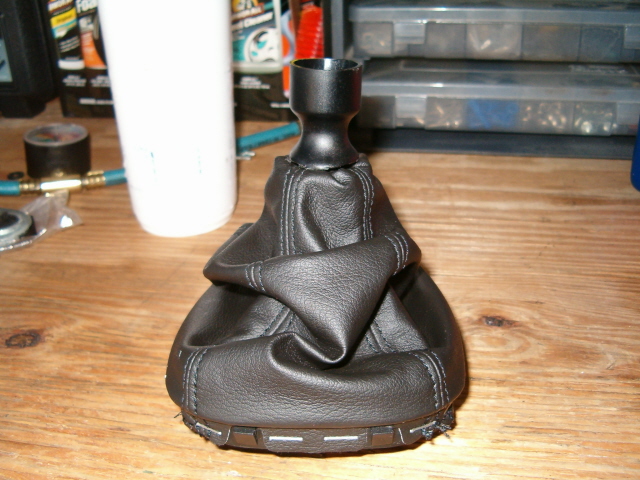

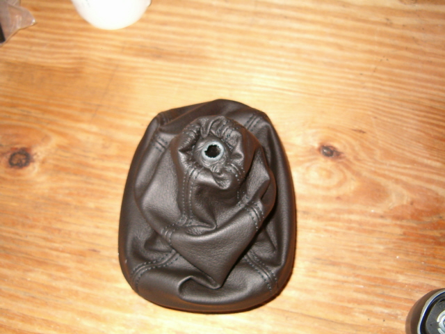

Shifter Knob Removal & Factory Quality Replace w/Any Knob
1st)Pop Cap On Shifter Knob & Remove Screw
2nd) PULL LIKE HELL
3rd) Pull straight back on dash end of boot, so it unlaches
4th)Slide Whole Boot & Reverse Lock out off Shifter Shaft
5th)Not needed but recomended, The Shaft on the Shifter is dull & dirty. To get it to shine Use Steel wool (FINE COURSE) or compatible with some metal polish. Will make it look really good if u take your time. (Some of the Shaft will show When you are done)

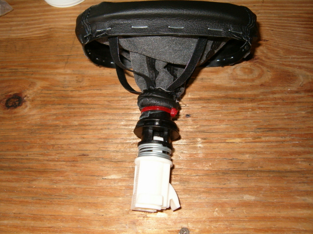

6th)Invert Boot Cut Zip Tie that Holds Boot on Reverse lock out. (Dont worry Leather wont Fall Apart,But make Sure to cut Zip Tie ONLY.)
7th) Cut Reverse Lock out just under Finger Grip & Flush with the top of the Boot. You Can use a Hacksaw or Power saw. (just make sure to REMOVE BOOT before you cut.
8th) Now Take The Leather off the Old Shifter Knob By Cutting The Stich then removing the leather.
9th) Cut a piece of Leather about half the lenght of wat you removed from Knob.
10th) Wrap Cut Leather over end of Reverse Lock out Where you cut it & Zip Tie in Place as Seen in pictures Red Zip tie.
11th) Now Place Boot over Top of Reverse Lock out (Note boot will Be inverted as seen in Pictures) Now Zip tie in place Black zip tie in Photos. Black Zip Tie Replaces one You cut in Beginning.
12) Reinvert your Boot & & Ready for Install, Cut the hole in the top of the Leather smaller than the Shaft so that it fits tight around the Shifter shaft (NOW YOU R READY FOR ANY SHIFTER KNOB YOU WANT & YOUR REVERSE LOCK OUT STILLS WORKS & IT LOOKS LIKE A FACTORY DID IT)
I Know it sounds Hard it is Really not & the Results look like Factory & U can put wat ever you want on.
By the way the Reverse Lock Out still works By Grabbing the Boot, Like In Picture.

Wasnt writting it up for opinions , Wrote it up to show how to put any KNOB u WANT on & how to Keep the reverse lock out working

Thanks Man seen lot of peps Having Problems with it . Thought i would show them how to use wats there & match the leather on the boot . Secound off you need the reverse lockout to keep gear shifter track aligned,,,other y's you over shift going into 5 gear.
