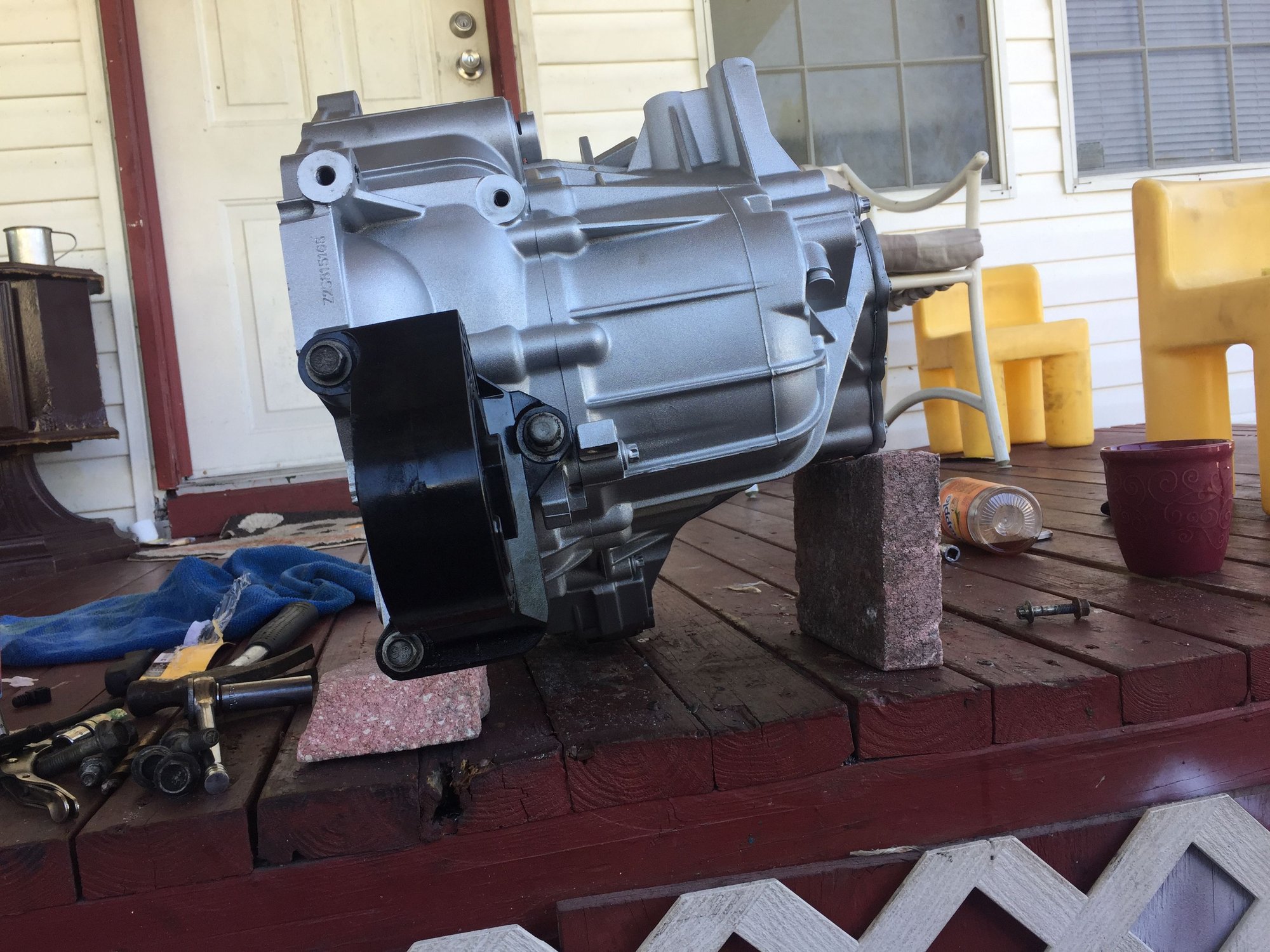

i got 2007 base model I've owed it for more than 3 years an in that time I've done a lot of research an finally paid of last week i swap my regular f23 m86 to mg3 from the saturn vue with has the shortest final drive and an shorter 5th. i have also done a saab high pressure turbo set up with intake mani as well from the saab. I've put 2.4 injectors for now currently not running a intercooler need to get some pipe !!! an a tune I'm currently making the down pipe with the original 90 elbow with the o2 bung just need to make it from there down. ill be posting up some pics an more stuff that I've got an will be doing in the future. thanks for your time hope my fraken slowbolt interest you.

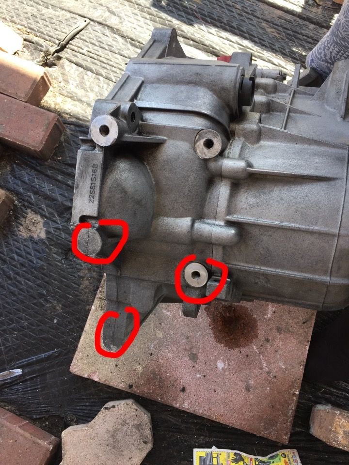

This is where the mount goes is the cobalt
Tapped an threaded with new mount that was refilled with urathane.
New axle seals an replaced slave cyl. Mount hadnt been fill yet here

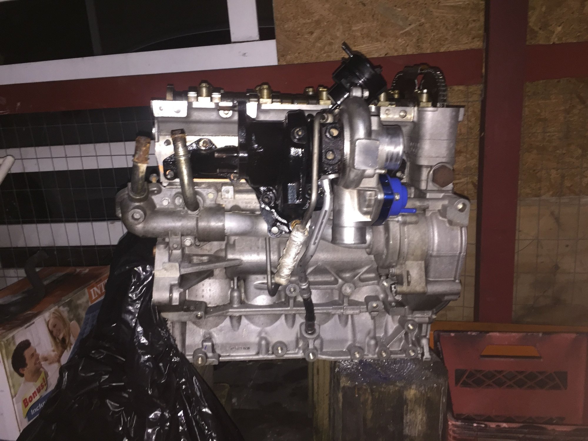

Mocking it up to see whats the way an reasure that i can use all the stock lines from the saab also messuring to see if stock oil return fits
Cleaned the motor taped for the oil return wich fit perfect an so did the other lines the only line that had to be cut was the water line that returns to the thermostat housing i cut it at that side an atached a hose to it an use the same t pipe from the other side in the saab
Painted the motor an heat wraped the manifold so the water pipe from the pump stays as cool as possible i had to turn the pipe a bit so the manifold would clear
Cleaned the bay an subfram
Painted the bay a metalic blue an resprayed the subfram
New gasket for the turbo. I cut the stock 90 from the saab down pipe with the o2 bung an im making it from there found a oem oil feed line that was cut an welded a braided line wich is awsome
Got it in looking real good
Turbo fit extremly good an still have room
Turbo in. saab manifold in.
Using the stock saab charge pipe wich goes under the pan an went straight up still need few more things buts its up an running more info an detailed specs later on

Pretty sure you will need much bigger injectors than the 2.4 Cobalt's to run a turbo especially if they are the same size as 2.2 injectors. Is that transmission brand new?

Stock injectors are 24#. You need bigger

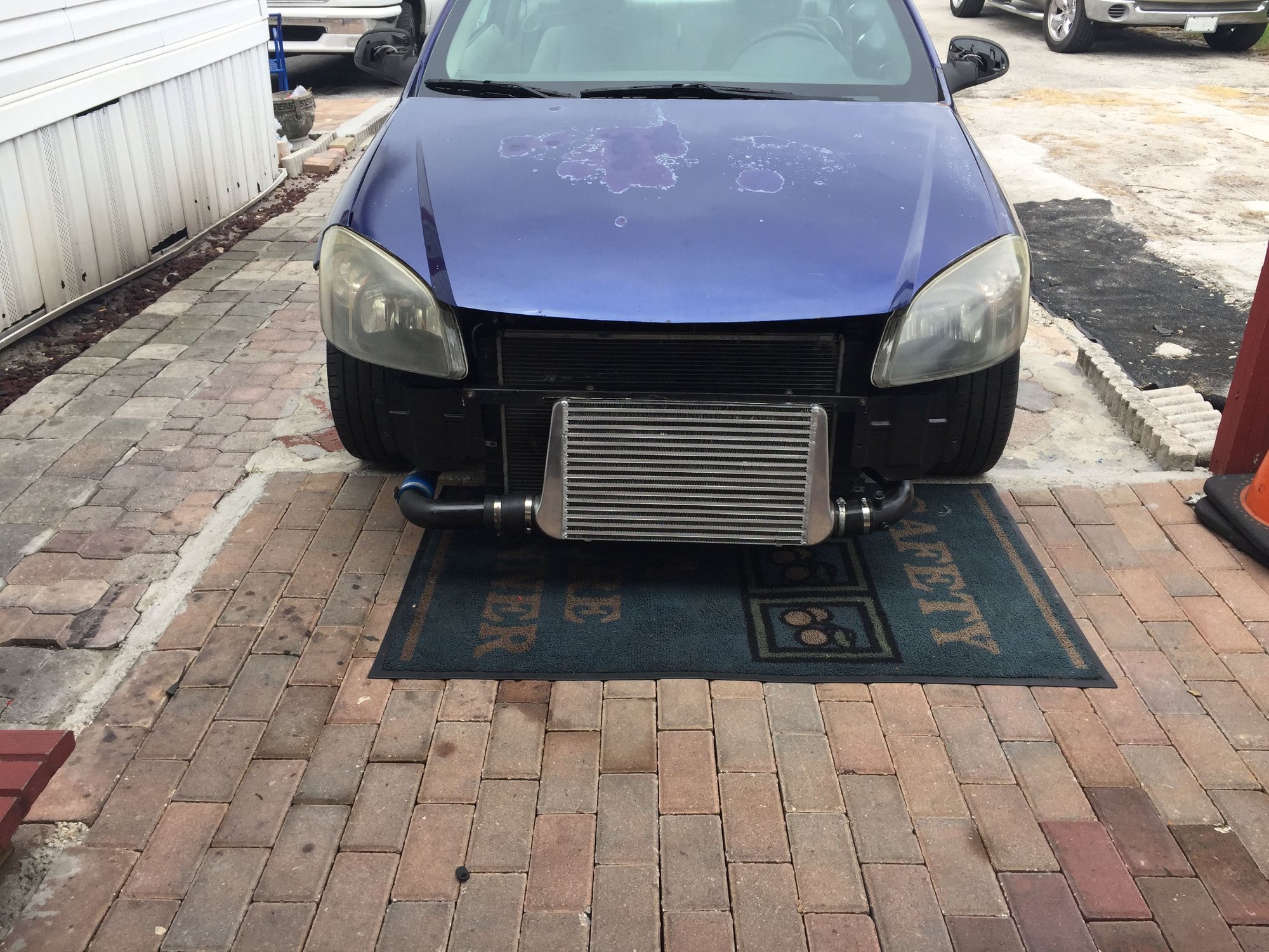

Slowly but surely
No brand bov with all wrinckle black paint
Working on the catch can.
Need some some air flow. Dont know how i feel about the grill thoe?
26”x12”x3” intecooler
The tranny is not brand new just in mint condition an painte

What's with the 3 holes in your bumper?

airflow to the intercooler.
So the only difference in the vue transmission case is the front mount bosses?

Why would you want improve airflow to only half of the intercooler? I assumed that is what the holes are for but if that is the case why not do it symmetrically? I thought that because they are off to one side maybe they are for something else.

I'm sure he was just wanting to see how it looked before drilling them all out, but I agree he should do them all the way and then add a wire mesh behind

it is for better flow sorry I haven’t updated ive been really busy will put some more stuff up soon
