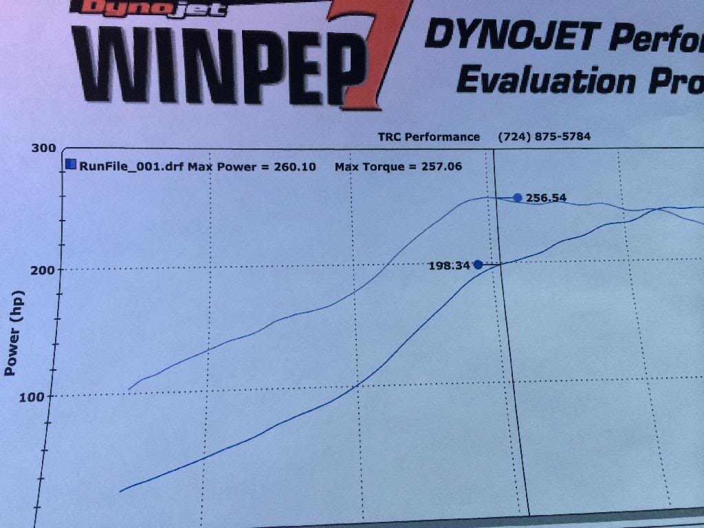

well last weekend i finally decided to dyno the car.
goal was 250whp, i can say im happy, as the car made 260whp and 257wtq on 8.5lbs of boost
bone stock motor and trans
l61 2.2
mods:
turbo kit:
-zzp stage 2 s256 turbo kit
-3in zzp gutted cat downpipe
-tial wastegate with dump recirc'd back into dp
-zzp 50mm blow off valve
-zzp charge piping custom powdercoated neon pink
-air to water intercooler set up
-03/04 cobra intercooler pump
-03/04 cobra 42lb injectors
-full 2.75 catback exhaust with magnaflow straight through muffler
-spec stage 3 6 puck on new gm flywheel
-ttr front and rear motor mounts
personally tuned by vince at Trifeca, afr's a dead perfect all the way through the rpms and loads!!
video is of a 4th gear pull, yes i got a small exhaust leak, havent had time to find it

Thats a good looking graph glad your happy with the results rb is right I love the look of your car
Not to break your ***** cause if your happy thats all that really matters but why spend the extra $$$$ to make 260 on a turbo capable of 500 when an m62 setup will do that all day

I'm sure Cory will chime in, but the reason he went with the s256 kit is because he got an awesome deal on it.

cuz the zzp turbo for the 2.2 was only a s256
They used to sell the 256 without extended tip and it was cheaper than the 252et.
Thats my guess
cuz m62 suck, to hard to make more power later and its not reliable on the 2.2, soo many blown up sc 2.2's at like 230whp, plus i paid $1200 for a complete stage 2 zzp s256 with 8k miles on it, when i go built motor ill drop 80's in it swap in the 11lb wastegate spring and crank the boost to 18lbs, instead of having to sell the sc kit for a turbo swap, do it right the first time
He probably plans on building it in the future
there is a spare 2.2 block with my name on it laying around, saving up and slowly buying sleeves, rods, pistons etc
