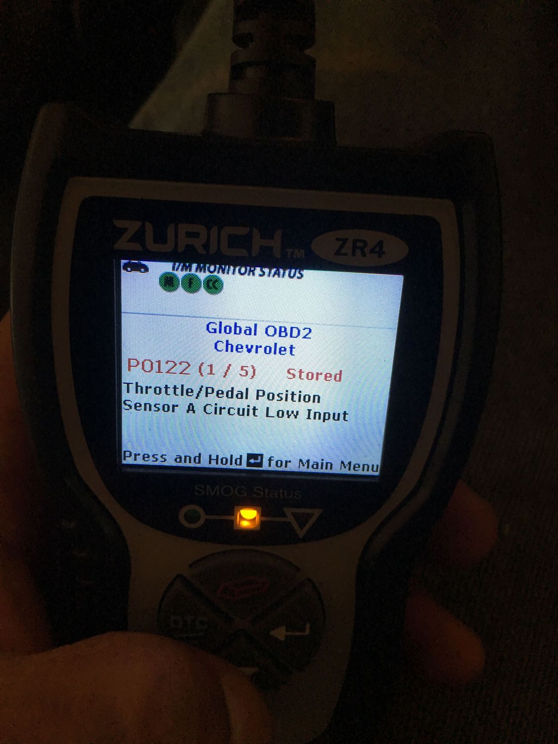

after doing some research between me and the performance shop guys, I replaced the factory plugs with a six heat range iridium plug, replaced all injectors with a used set from an 09 and replaced the fuel rail pressure sensor. I hooked a manual pressure gauge up and tested the in-tank fuel pump (around 63 psi). I also hooked the OBD-II and watched live data on the fuel rail pressure, which is only about 60-70 psi when running or in key on mode. I know it's supposed to be light years more than that. Also, the last time I drove it, it went into REDUCED ENGINE PWR mode, and now it shows 100% throttle on the scan tool no matter what. I have codes and live data video I can post also. Any questions, please ask. I desperately need to get this car running. This has been a year long process. Apparently I can't post videos, but i do have some of the live data from the scan tool. Thanks in advance.
https://cimg0.ibsrv.net/gimg/www.cob...faa2659ff4.jpg
https://cimg7.ibsrv.net/gimg/www.cob...a2fa4b851a.jpg
https://cimg6.ibsrv.net/gimg/www.cob...d47df824d8.jpg

I've reset the codes atleast 20 times during this process via the parts store, 2 different code readers and disconnecting the battery for long periods of time. They come right back as soon as you start the vehicle. Although it does start and run, it's not drivable. Plus, I only have 63psi for rail pressure, and everything I've read says to not run the car hardly at all with that low of pressure. I've read a thread about the ZZP cam I have, and some guys were saying they've had trouble with it. I hope that's not my case, but the only fuel related parts I haven't changed is the HPFP and the solenoid or sensor that is attached to it. Also, the in tank fuel pump is the same, but it checked out good pressure wise. I'm not sure how to test the HPFP.
