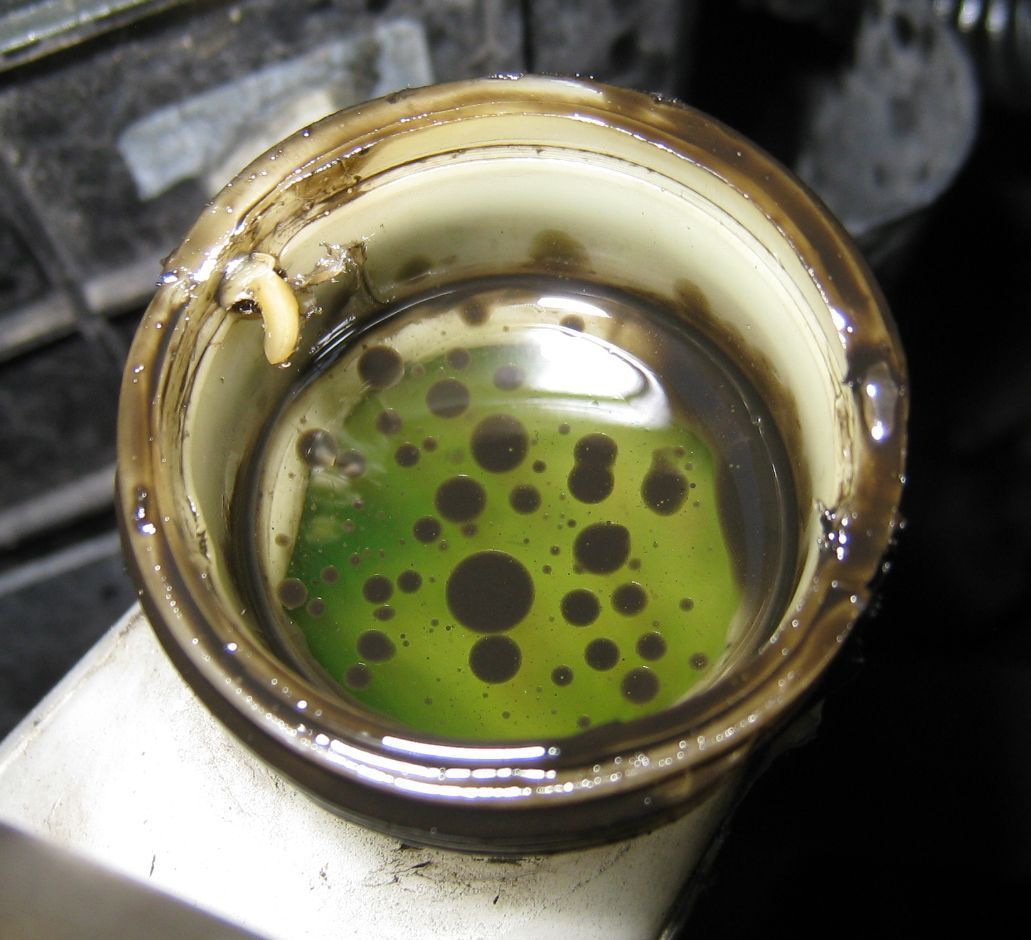

I have a stock 2005 Saturn Ion Redline with an issue. Everything had been normal until on a ~100 mile trip, the temperature suddenly climbed into the red when driving along a 50 MPH road. I slowed down to below 25 MPH until I could get to a safe place to pull over to wait for a tow, and the temperature dropped to just below the red. Foamy brown oil/coolant had blown out of the coolant surge tank and covered the left front wheel well. The engine was about three quarts down on oil. There was no observable coolant in the oil. There was no smoke in the exhaust.

Are you sure there is oil in the coolant? I just ask because your coolant could easily be brown as your car is a 2005 and if it has never had the coolant flushed or had green added to the dexcool it can make it brown. The second time you had "oil/coolant started spewing out of the surge tank" did you also observe another sudden loss in oil?
Although it is possible I doubt it is likely that oil is entering through the oil/coolant heat-exchanger.. If it was I would think it would not be intermittent and the mechanic would have seen the problem duplicated. Although it would explain the oil loss I don't know how that could cause you to suddenly overheat either. I wonder if you possibly have a head gasket issue.

Yes, I'm sure of it. See the attached pictures from the first overheating event. After the first mechanic that AAA towed the car to refused to do any more diagnostics on the car after observing "oil in the coolant," I refilled the surge tank with distilled water and drove the car about a mile home (again overheating right at the end of the trip after behaving normally up until then. The second mechanic refilled the coolant with whatever antifreeze he had, and when the car overheated on the way back home after he failed to replicate the problem, the foam looked exactly the same as it did the first time.
The problem is always "duplicated." The mechanic just didn't run the engine under load long enough to see it. I suspected the oil cooler because this guy on the Redline forums had identical symptoms, and it turned out to be the oil cooler: https://www.redline forums.com/forums/problems-troubleshooting/89048-head-gasket-gone-2.html (remove the space)

Holy **** those pictures. Could very well be your oil cooler just never heard of that happening. I guess maybe the layers of the oil heat exchanger are separating some when the oil pressure is high enough though that would have more to do with RPM than load.
The heat exchanger is mounted right off the right side of your oil filter housing straight to the side of the block. The easiest method I can see to test it would be to remove the coolant lines and loop them together. Start the engine and raise the rpms. If oil shoots out of the heat exchanger you've found your problem.
