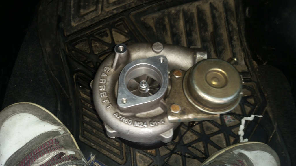

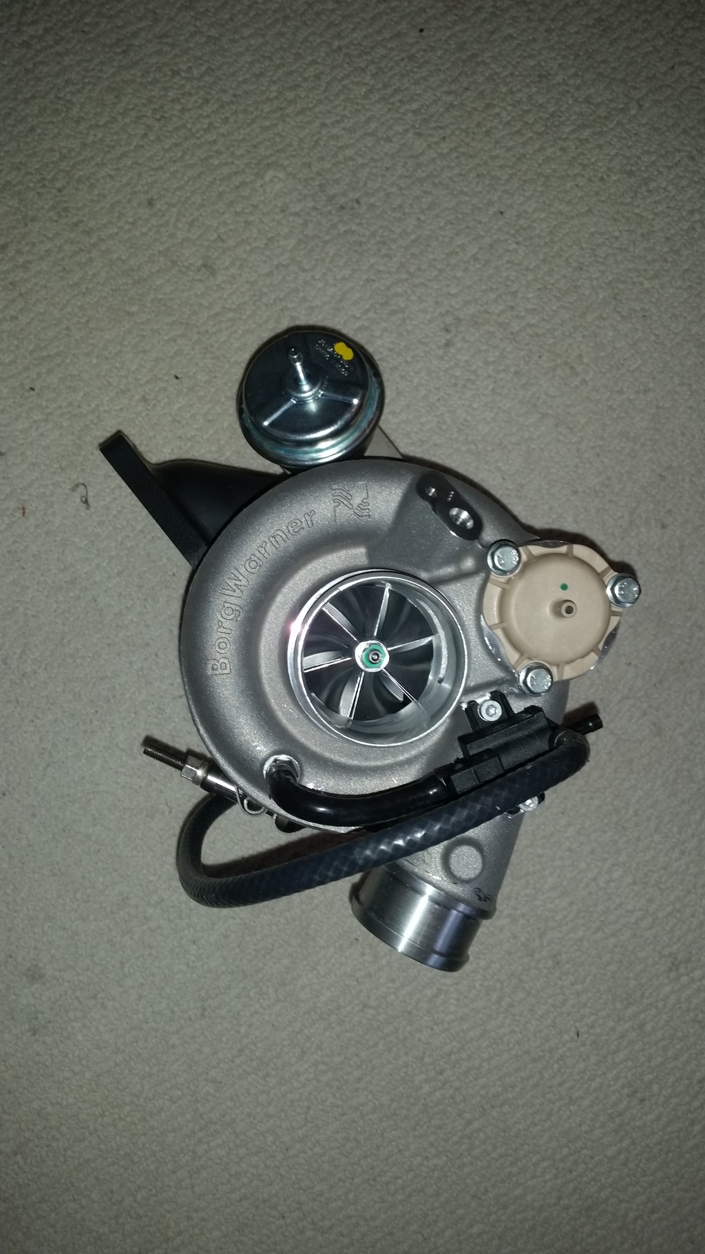

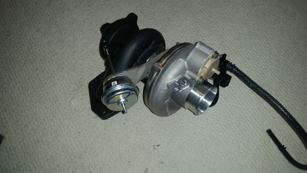

We picked up a Garrett GT2871r I think it's a little bit small for my tastes but I bought it for him and got a killer deal

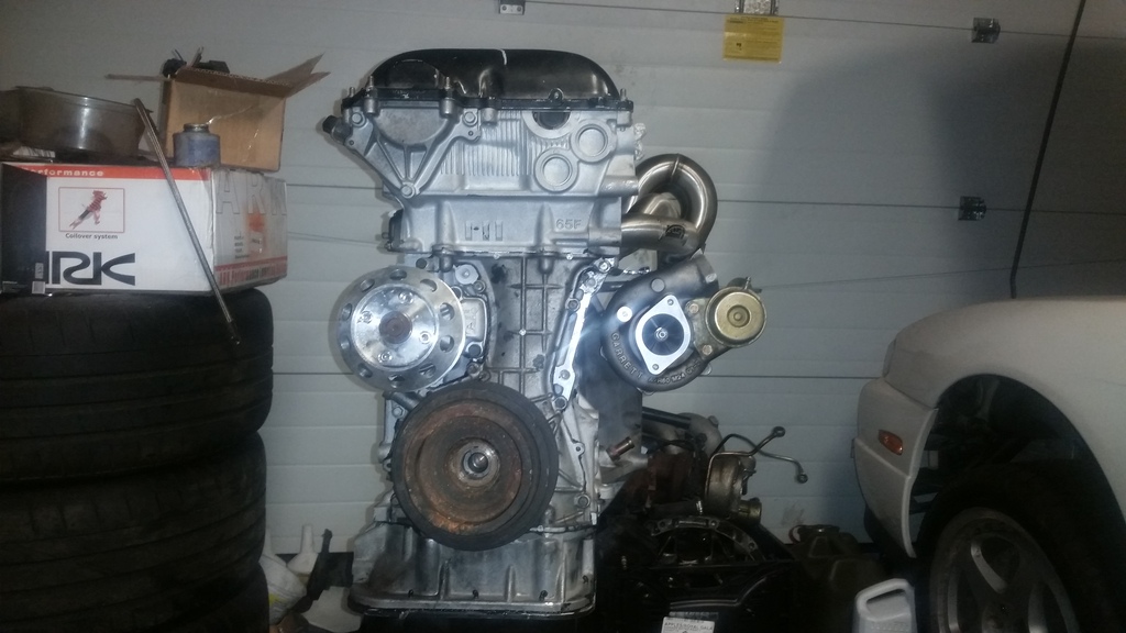

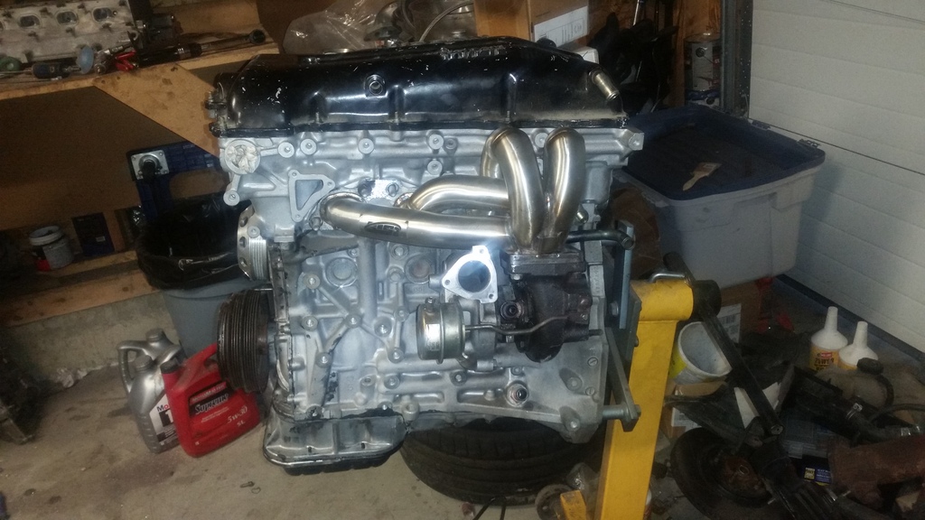

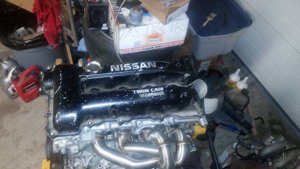

Engine pics
We're gonna do some Candy Red paint on the valvecover and a balancer is in the plans as well
I'm looking to throw it in one of these weekends coming up here soon but I need to port my head and finish the LSJ gtx3076r swap as well so I'm kinda busy

The T28 or 2871?
2871r
Turbo Compressor Turbine
Turbo PN CHRA PN Ind Whl Dia(mm) Exd Whl Dia(mm) Trim A/R Whl Dia(mm) Trim A/R
472560-15 446179-67 51.20 71.00 52 0.60 53.90 76 0.64

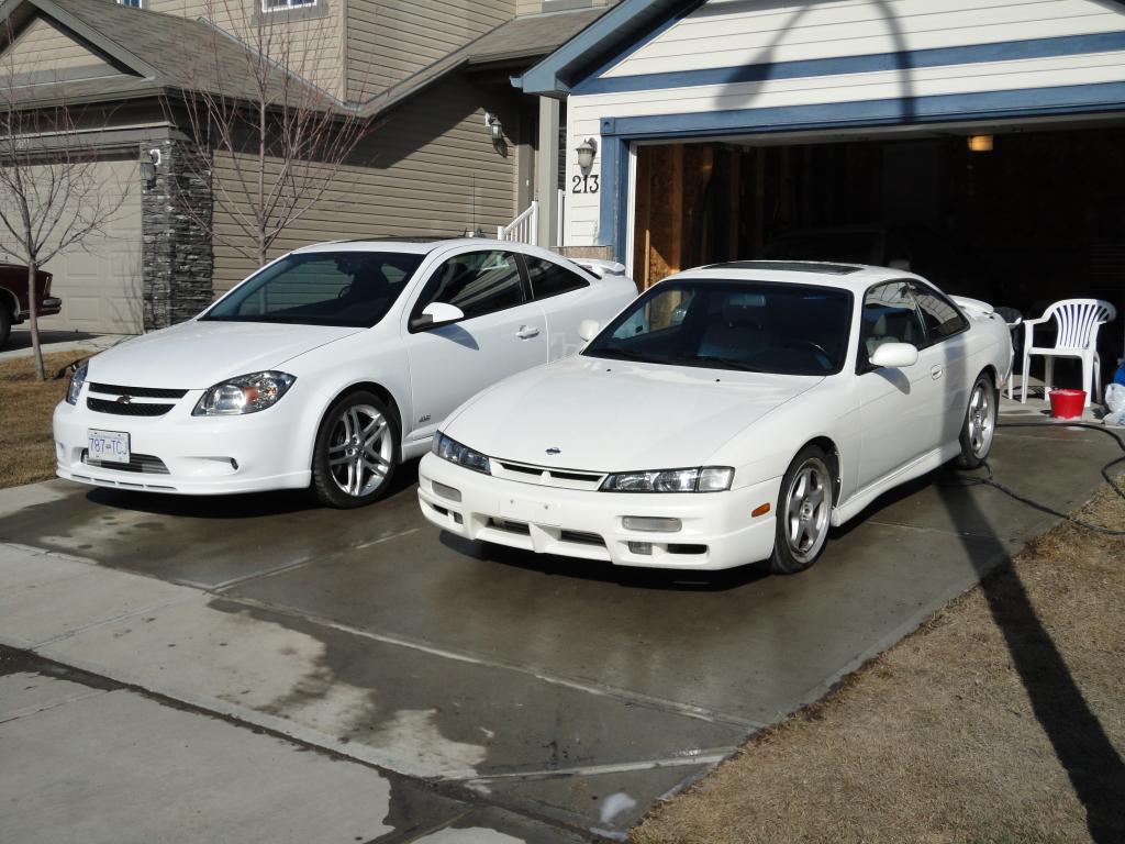

Here's mine

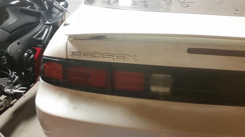

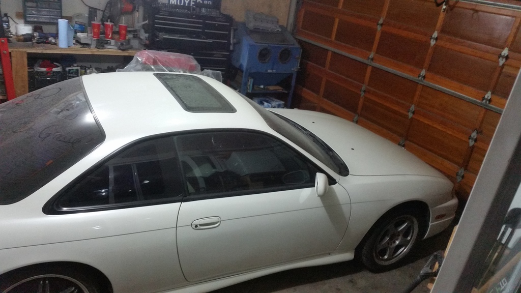

Well it's been just over a year since I last talked about this but I'm FINALLY throwing the heart back into my brother's 240!! I get my engine next week so I'm planning on having this done before next weekend.
First time she hasn't been home in at least 4 years
