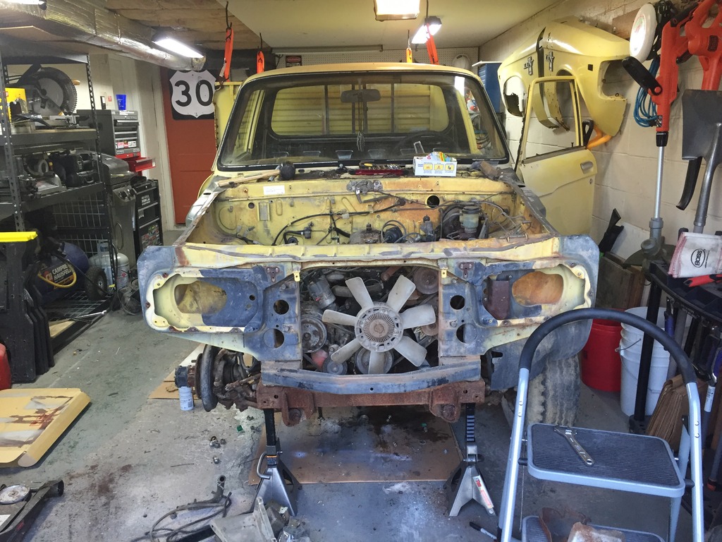

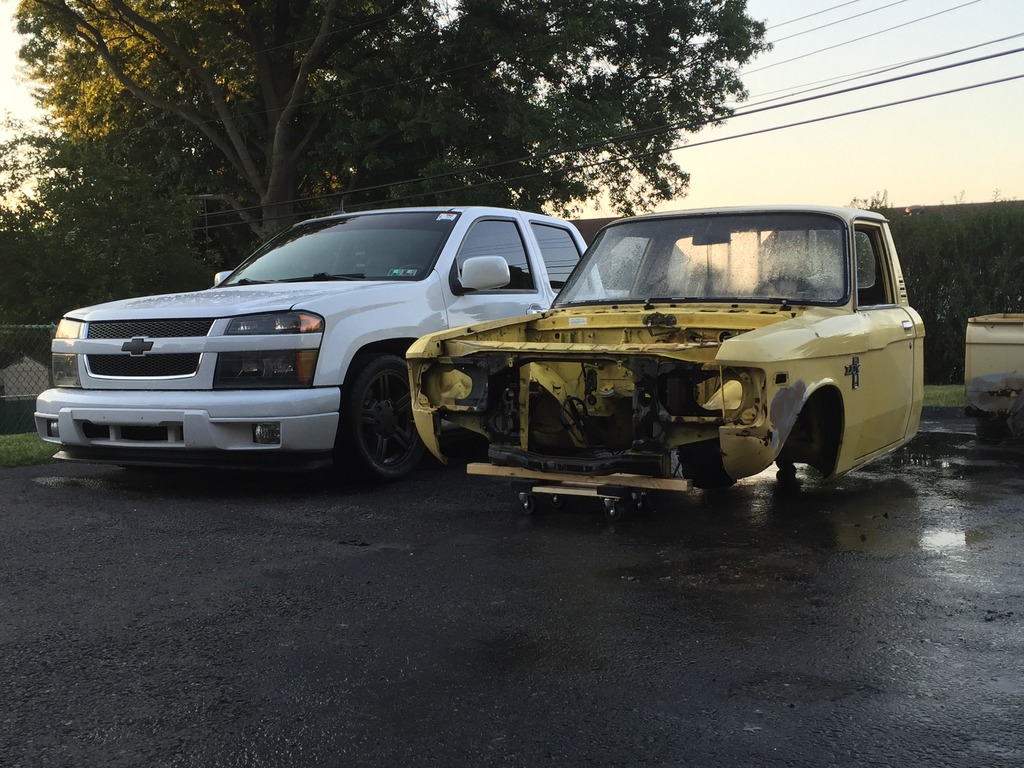

At the same time, I've never really been a car guy, and have always been more inclined to own small pickups. When this little guy reared it's head on Craigslist, the wheels in my head started turning, and a week later, it was following me home on a trailer.
Sitting in my driveway, with all the spare parts removed from the bed.
Tear down has begun, and I am in the process of removing the original motor and drivetrain. I was going to wait until I at least had a motor to start a build thread, but I have to many questions that need answered before I even track one down.

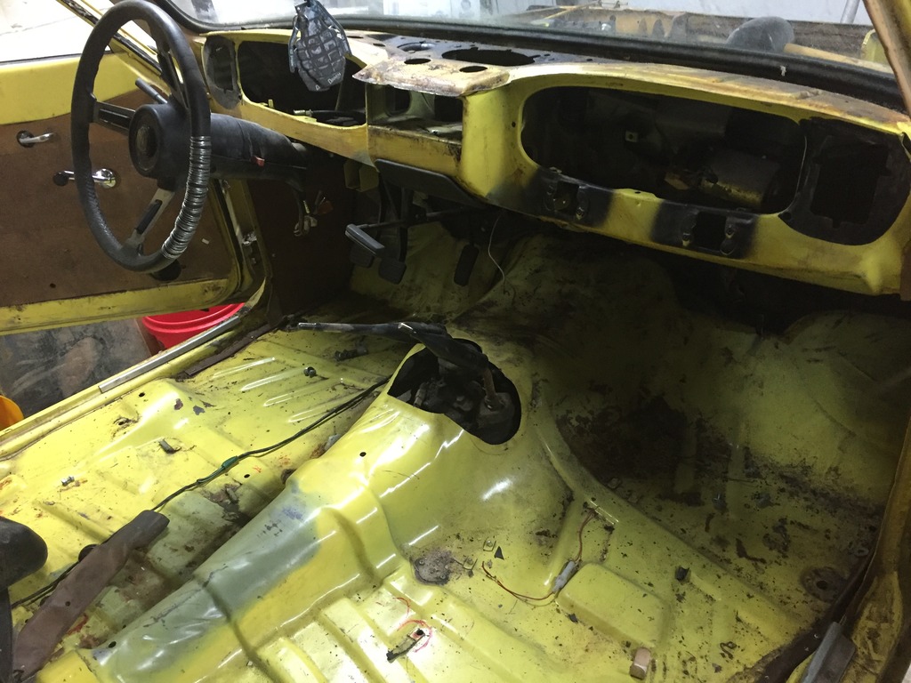

Gutted what was left of the interior.

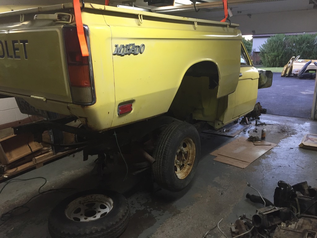

And the bed, dangling from the ceiling lol.

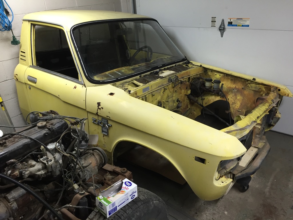

Yanked the cab off the frame tonight. Going to start grinding all the unnecessary tabs out of the engine bay and clean it up for paint.

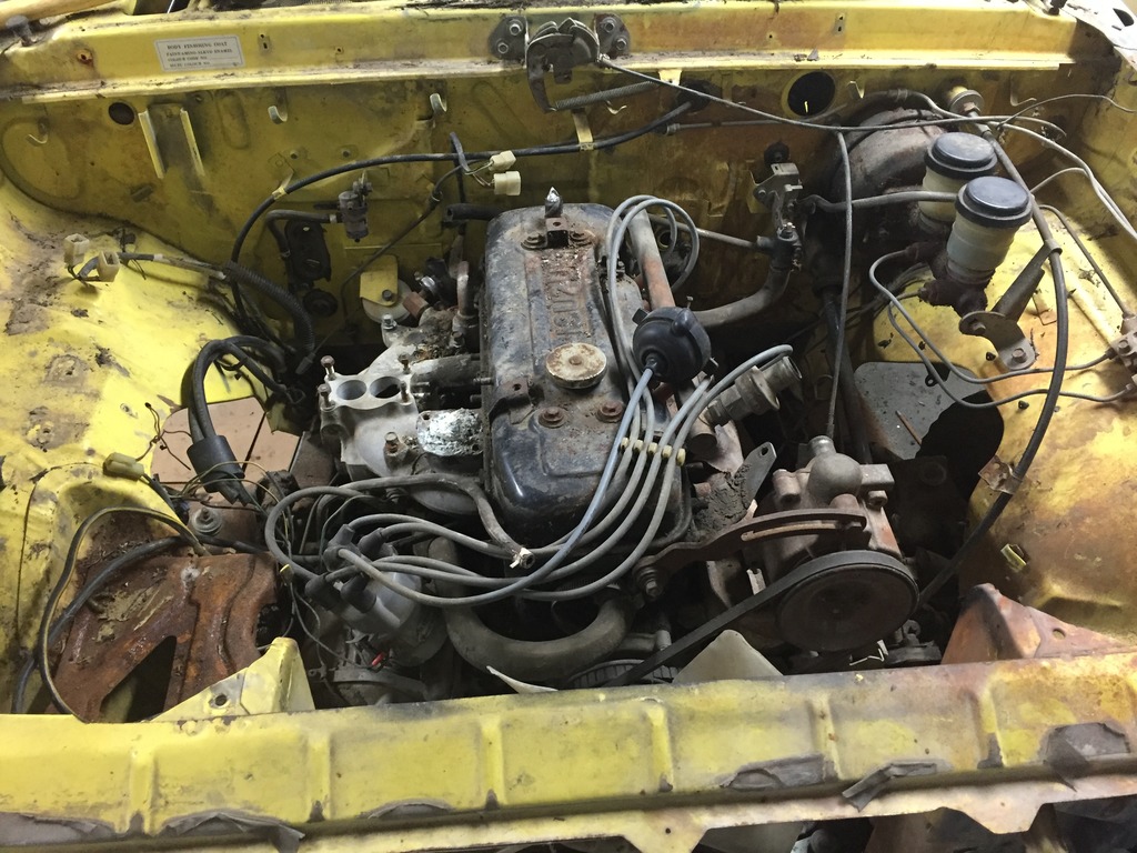

Pressure washed all the crud out of the cab and engine bay. I can't believe how gross it was.
