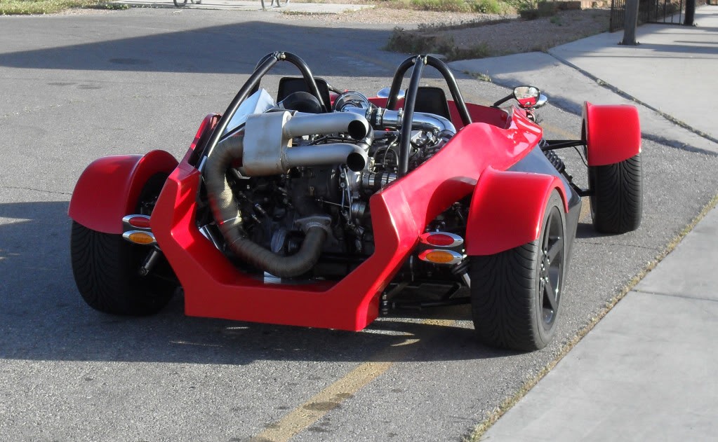

Thank you for viewing my questions. Ive been searching this forum and working on the engine for 8 months to get to... well, nowhere. It runs and drives, but in limp mode only.
The car in question:
The engine in this car (Superlite Razor, by RCR) is from an 08 HHR SS. I have the Trifecta software and have been working on trying to reset/replace all the issues that Ive been having (LOTS of Check Engine Lights). Ive only had this car at "full" power a couple of times. Its ridiculous how fast it is.
It continuously "pops" the MAF sensor as well as many others. Ive replaced nearly every sensor on the car. The engine is STOCK, other than the intake and exhaust. I just cant seem to figure this thing out. It always drives in "limp" mode, or, running 2-3 psi TOPS!!!
Is there anyone in Vegas that can help out? Anyone know these engines in and out?
Thanks again!

Also. Where is the MAf located? in the stock location or re routed? can you post a pic of the engine? is there an 02 sensor in the exhaust piping? turbo manifold?

thats pretty awesome. if you keep popping maf sensors you should try the GMS1 sensor upgrade.
crate engine depot sells them. you'll need two. also if you don't want a mess of rewiring buy their pigtail which allows you to plug and play.

Are you running a modded version of a Trifecta tune for the setup the engine is on? you cant possibly be running the full wire harness on that setup. I know Vince(Trifecta owner) has been able to get the LNF to run on an airboat and a bunch of other vehicles. It just needs to be customized so that the ECU ignores a lot of the sensors and stuff that are found on a stock HHR/Cobalt, but not present on your setup.

Guessing he had Vince write a solo tune for the ECU, from my knowledge it doesn't play without the BCM unless its setup in standalone mode. Just like the guy that built an air boat with the LNF in it.
That BPV has got to be wicked loud right next to your ear

Email Vince, he'd be the guy to talk to about tuning issues since you're a standalone project. I'd be willing to bet that he has the most recent tune file and can probably send you the downloadable "stuff" you need to make this project work correctly. He's a good guy to work with.

now. If your running a basic tune from Vince, You need a retune since you dont have the same sensor set up. This is def a custom tune needed.
Id also advise HP tuners and Terminator 2 tune.

Map sensor code...well theres the MAF sensor. and the MAP sensor. isnt there 2 map sensors?
maybe wrong bar tune on the map sensor?

drivable as in, still throwing limp mode and cel but you can drive it?
I think you need trifecta to make it stand alone but HPT you could do the tuning.
So for a stock LNF, the intake has the maf in the intake, Then one of the map's on the intake manifold and one on the cold side of charge pipes after the IC.
How is your intake, from intake filter to intake manifold setup?

just get in touch with vince from trifecta. he was the one who made that airboat work standalone without the body control module. guy is a software genius and has plenty experience with the lnf standalone

The HPtuners is a good bet. You can do just about anything with them...
OP- make sure the wiring to the MAP sensors is ok. There are 2 of them, one should be in the cold side charge piping and one should be in the manifold. Check to see which ones they are as well, if they are blue they are 3 bar MAPs and they need a special tune file. If they are grey they are stock ones. There is a known problem with the 3 bar MAPs concerning the wiring of the harness, if a dealer installed them in the car it was pulled out of they may ahve only used crimp style wiring connectors instead of soldering them together. I am pretty sure Terminator2 can tune that thing with or without the BCM connected to the car. The VATS system just needs to be calibrated I believe. If you want an HP tuner in the Vegas area hit up Joe or Chris Warner. They are both on here. Chris' S/N in Warner and Joe's is 07SSYellow. They have a HPTuner computer and should be able to get that thing going. PM Terminator2 on here as well just to see what might be needed as far as tuning without the BCM. HPtuners will be able to tell you more about what is wrong with the tuning anyways, because you can see what the computer is seeing.
