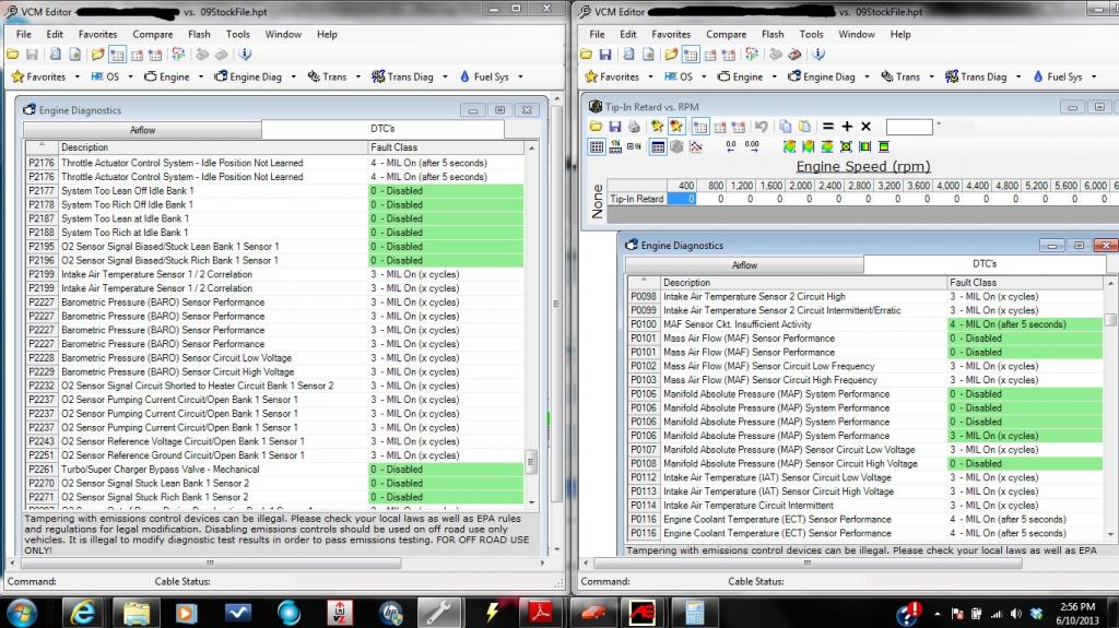

I forgot I had these bad boys kicking around. I blacked out the file names because fingers don't need to be pointed anywhere as far as who's cars they are. Here are a couple examples of tune files that I had repaired for a guy on here and another sent from someone asking me to help him with issues he was having. I wish I could fit a little more in the screen shot, but the disabled DTC's and Tip In Retard removal should be enough to add to the OP's point. The disabled and modified DTC's are highlighted in green because they are being compared to the stock files just in case a few of you didn't realize. Some of the b1s2 DTC's I can maybe accept due to a catless dp but everything else is just straight up ridiculous.

My opinion of him isn't high. I'm not going to bash the guy - seems like a nice enough guy. I knew there was a problem though the moment he said an s20g was bigger than my s256et.
And why tune an lnf for 26 degrees of timing on e85 when it's stopped making power at 23 degrees lol
