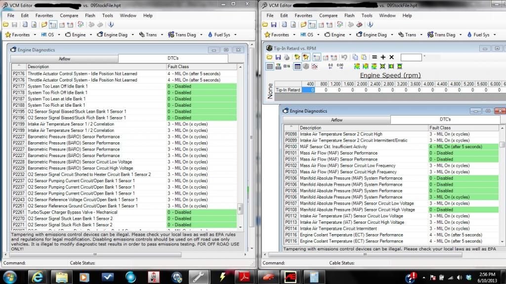

Originally Posted by 09CobaltSS1
I forgot I had these bad boys kicking around. I blacked out the file names because fingers don't need to be pointed anywhere as far as who's cars they are. Here are a couple examples of tune files that I had repaired for a guy on here and another sent from someone asking me to help him with issues he was having. I wish I could fit a little more in the screen shot, but the disabled DTC's and Tip In Retard removal should be enough to add to the OP's point. The disabled and modified DTC's are highlighted in green because they are being compared to the stock files just in case a few of you didn't realize. Some of the b1s2 DTC's I can maybe accept due to a catless dp but everything else is just straight up ridiculous.
Looks damn near identical to every file that has been sent to me....

It can't be tho, James does not disable codes. lol
I like James, great guy and I do think he really knows his stuff. But I don't understand how his "nutswingers" as some call them can sit and defend when the facts, proof, etc. are right here.
I put nutswingers in " " because I don't think defending someone makes you one. You are obviously going to defend the person, especially if you have had a good experience.
I have had both good and bad experience with James when it comes to tuning. On a personal level James has been nothing but good to me. I wish he would just put the pride aside and own up to mistakes. He keeps saying "it's what the customer wanted", well i'm pretty sure they didn't ask for a bunch of DTC's shut off and an unsafe car. Even if they did, you say NO, and if they decide they don't want your services then oh well, less headache.

Putting power aside. Regardless of how much or little power the car makes, if there is any sort of issue with the car and those particular sets of DTC's are disabled the customer or mechanic working on the car would really have a hard time pin pointing an issue if it's unable to throw a code.
It's like when someone says, "I'm having X problem and Y problem with the car but it hasn't thrown a code". All symptoms with X problem point to a MAF issue and symptoms for Y problem point to a bad MAP sensor yet no codes are present. Pull the tune file as a last resort. Oh look, the MAF and MAP codes are disabled for some ungodly reason. That's odd, my tuner would NEVER do that. Re-enable the codes and boom, P0101 and P0106 pop up. The issue in this example could have been a bad sensor, a boost leak or even worse, but no one would have known nearly as fast because no DTC was thrown. This is an extremely shitty way of claiming that "the cars I tune don't throw codes". Why? There's your answer.

I just posted 2 more examples of him doing just this above. Who knows how many other cars are out there like this. Maybe these are the only 3 that exist, however I somehow very much doubt that.

^^^^^this. No doubt. Irresponsible.
