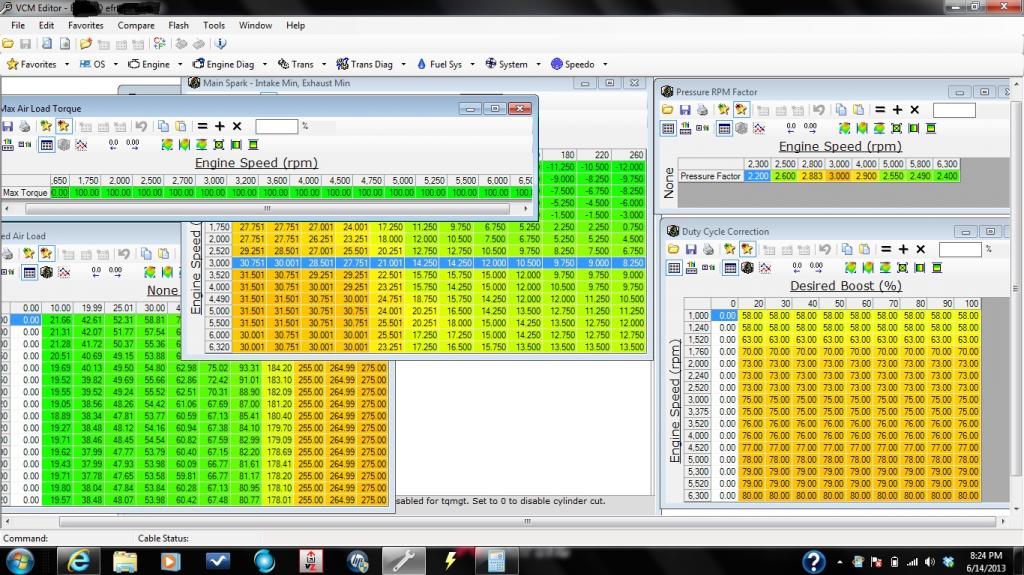

I wonder how it compares to his ZFR tune that I had posted a screen shot of with all the disabled dtc's.
Post up the wg tables. You saw the ones I posted all 52-57% almost everywhere with a stock pressure factor vs rpm table.
Strangely enough the wg tables look a little more reasonable than the one you had posted, but it's still junk. Can anyone say throttle/boost light switch? lol Also tip in timing is far too high, MALs are just silly, Pressure RPM Factor is exactly stock which is commanding 20psi up to out of a 25psi tune, and there is clearly going to be a large boost spike down low. Even with the wgdc being set at 75% in the 3k-4k areas and tapers up, I have seen as high as 27psi come from a 6758 depending on how the wg rod is adjusted. I'm sure you have as well. Now imagine what it can do with no other boost protection/limits in place. Yikes....
