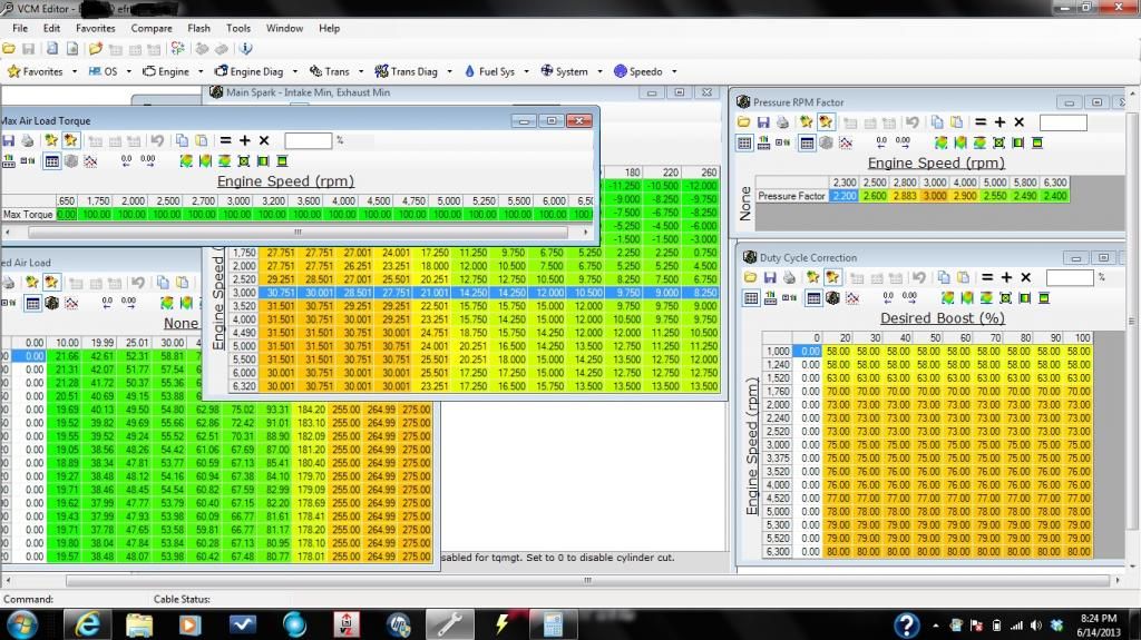

Originally Posted by 09CobaltSS1
Strangely enough the wg tables look a little more reasonable than the one you had posted, but it's still junk. Can anyone say throttle/boost light switch? lol Also tip in timing is far too high, MALs are just silly, Pressure RPM Factor is exactly stock which is commanding 20psi up to out of a 25psi tune, and there is clearly going to be a large boost spike down low. Even with the wgdc being set at 75% in the 3k-4k areas and tapers up, I have seen as high as 27psi come from a 6758 depending on how the wg rod is adjusted. I'm sure you have as well. Now imagine what it can do with no other boost protection/limits in place. Yikes....
Holy mother of light switch that car goes from 20% throttle and 5 inches of vacuum straight to 100% throttle and max boost without even moving the pedal. Too much wg dc in the lower desired boost areas and with a max airload without a smooth ramp up yes it is likely to have a spike then drop off to 20 psi up top as indicated by the 2.4 limit in the pressure factor vs rpm table.
Looks like my file I sent you last year... You have to mention at least this is not the finalized file. This is like the third or fourth revision for my ZFR when I had wastegate issues. We talked about it before and it did need more tuning.
I was trying to not name any names here, but yes this is your tune. You're right, this isn't a final tune but it is however the 8th revision he had you on so I wouldn't really consider it anywhere near a base map either. This is also one of the 2 tune files I made screen shots of showing examples of all the dtc's he disables. I do recall you having issues with the turbo (which I had advised you to adjust the preload on the wg) and asking if I'd also be willing to fix the tune for you because James wasn't responding to your attempts to contact him. I usually have no issues with helping people (and I certainly have no issue at all with helping you out, otherwise I wouldn't have given you my number when you reached out to me) but James was/is your tuner and I had no interest in getting involved with the tuning aspect of things and dealing with his bs firestorm for doing so.
As far as it not being a finalized tune, the odd thing is just how similar the tune actually is to quite a few of his other zfr tunes that were deemed "finalized" by him.
Please don't take this as me coming at you btw, because I'm not nor do I have an issue with you in the least. Otherwise I would have posted your name all over this tune file. I'm just saying it how it is and presenting what I have.
