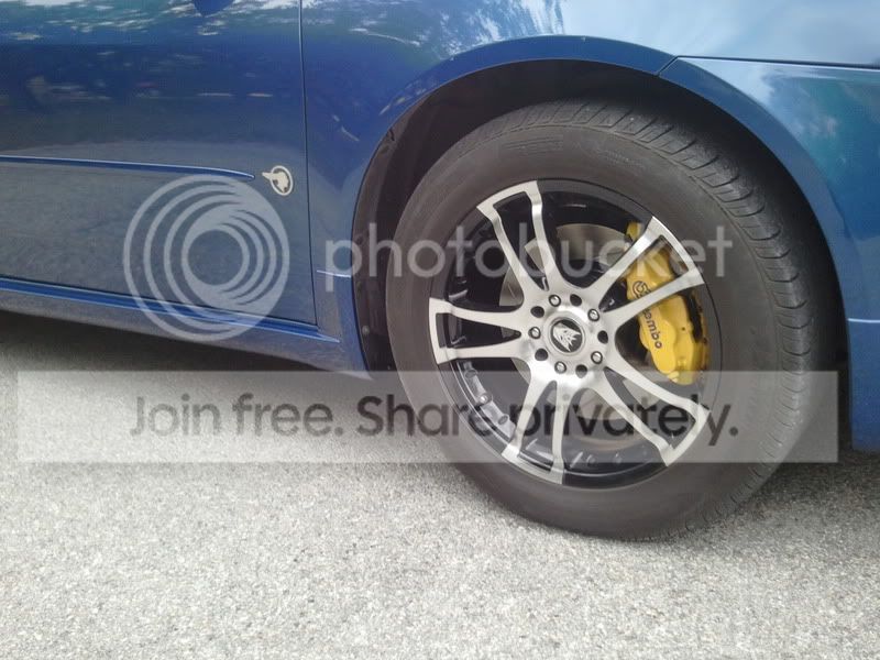

*Official* List of SS/TC Rims
Old May 10, 2012 | 11:05 PM
  #401
padlock's Avatar
Joined: 07-20-09
Posts: 5,305
From: Platteville, WI
17x7.5 liguid metal venoms with 5mm spacers on a guys g6

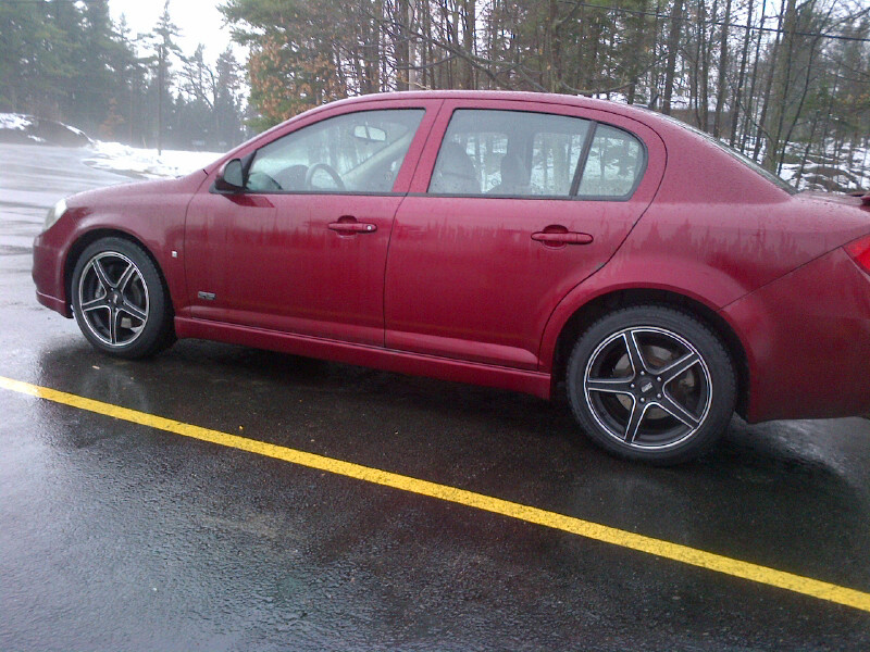

I just bought a set of the Sport Tuning T1 wheels in 17" size with winter tires and they fit just fine on my '09 SS/TC. There is only about 1 or 2 mm space between the front caliper and the back of the wheel spokes but they clear without worries.

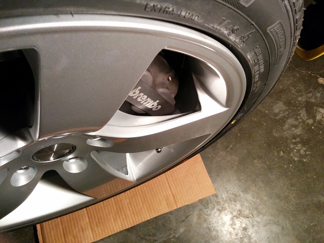

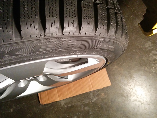

Just because I know you all love hearing that SS/NA wheels fit without a spacer. Here's a set of 17"s off a 2010 LT, same wheel just in painted silver. They spin just fine but I'll be tossing some 5mm spacers in soon, I don't trust our wheel bearings enough to not eat caliper or lock a tire mid corner.

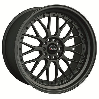

Anyone know if hub swapped to 5x114.3 if xxr 521 18x8.5 will fit around the brembos and what offset they might? Maybe a +25 I am not sure.
