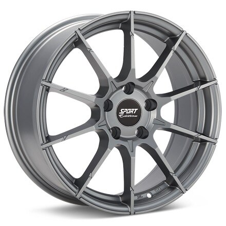

Anyone tried the Sport Edition A16? They come up on TR when searching for an SS/SC, but not the SS/TC, so I'm guessing a spacer will be needed, but not sure what size to try.
17x7.5 +42
https://www.tirerack.com/wheels/WheelCloseUpServlet?target=runWheelSearch&initialP artNumber=A167704MT&wheelMake=Sport%20Edition&whee lModel=A16&wheelFinish=Matte%20Titanium&showRear=n o&autoMake=Chevrolet&autoModel=Cobalt+Coupe+with+5 +Lug+Wheels&autoYear=2007&autoModClar=SS+Superchar ged
