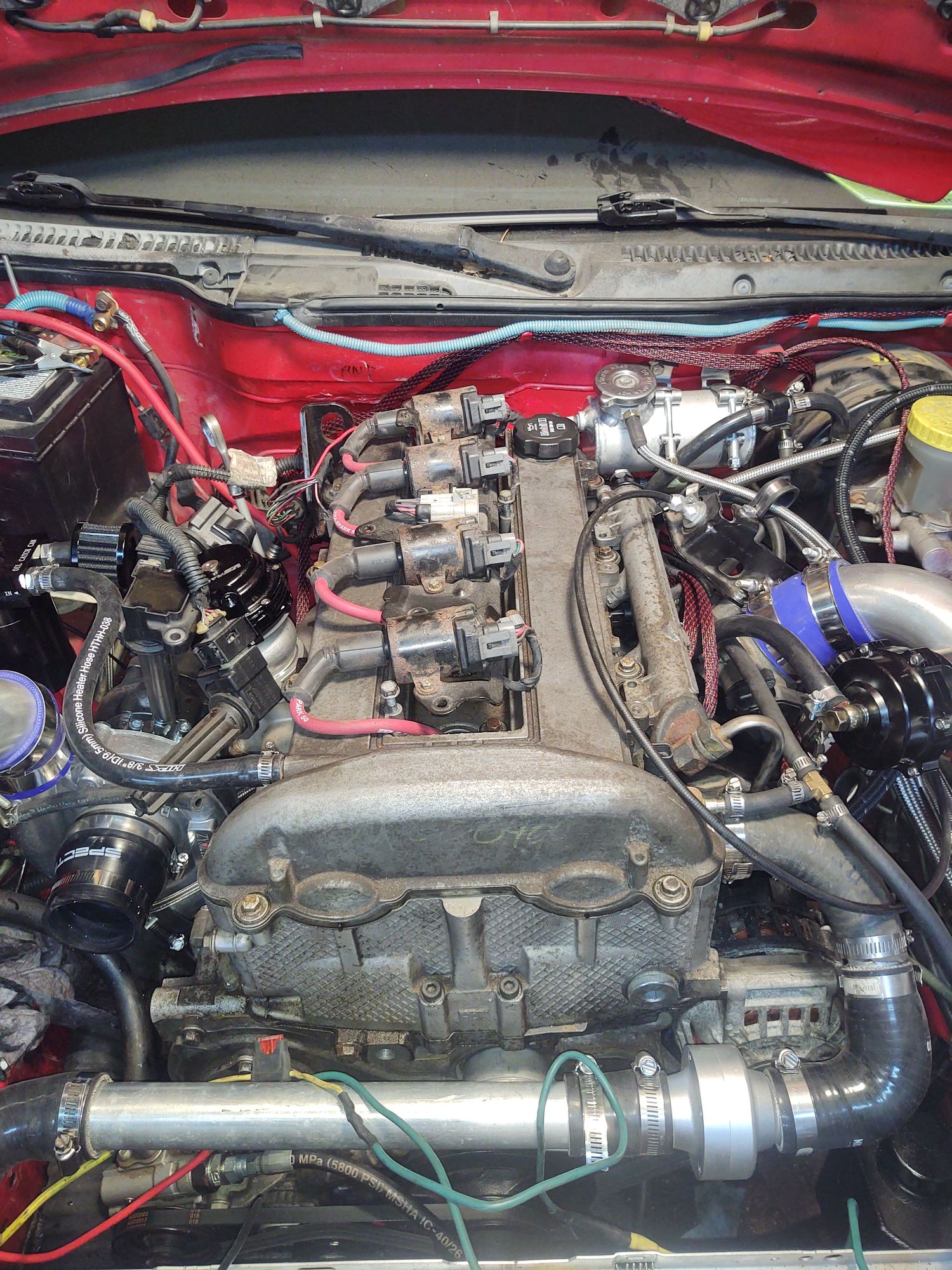

D585 LS coils, same settings as the LSJ COPs. Theoretically should work with a stock pcm. running 3ms dwell. this was mlre lf a troubleshooting measure and less of. An upgrade. They work great though, and readily available. I also cut and ran a fresh AN 10 oil cooler line to the side of the radiator. It cleaned up the bay massively
