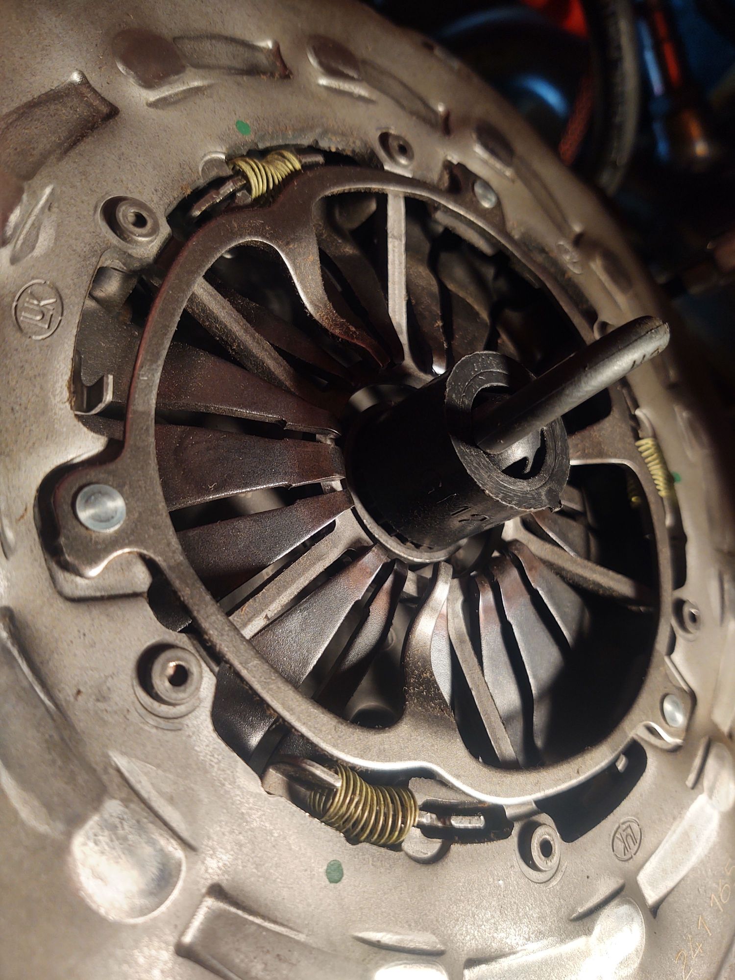

Tried an OE clutch, and it drew the fingers to the end of their travel. I consulted the RWD group on Facebook, apparently some people have to run pressure plate spacers. The fidanza flywheel could be off3-4 mm, taking up all of the travel. Ill keep the thread updated, hitting road blocks but learning a ton. I ordered "stand offs" from McMaster, as a gentleman on FB did
