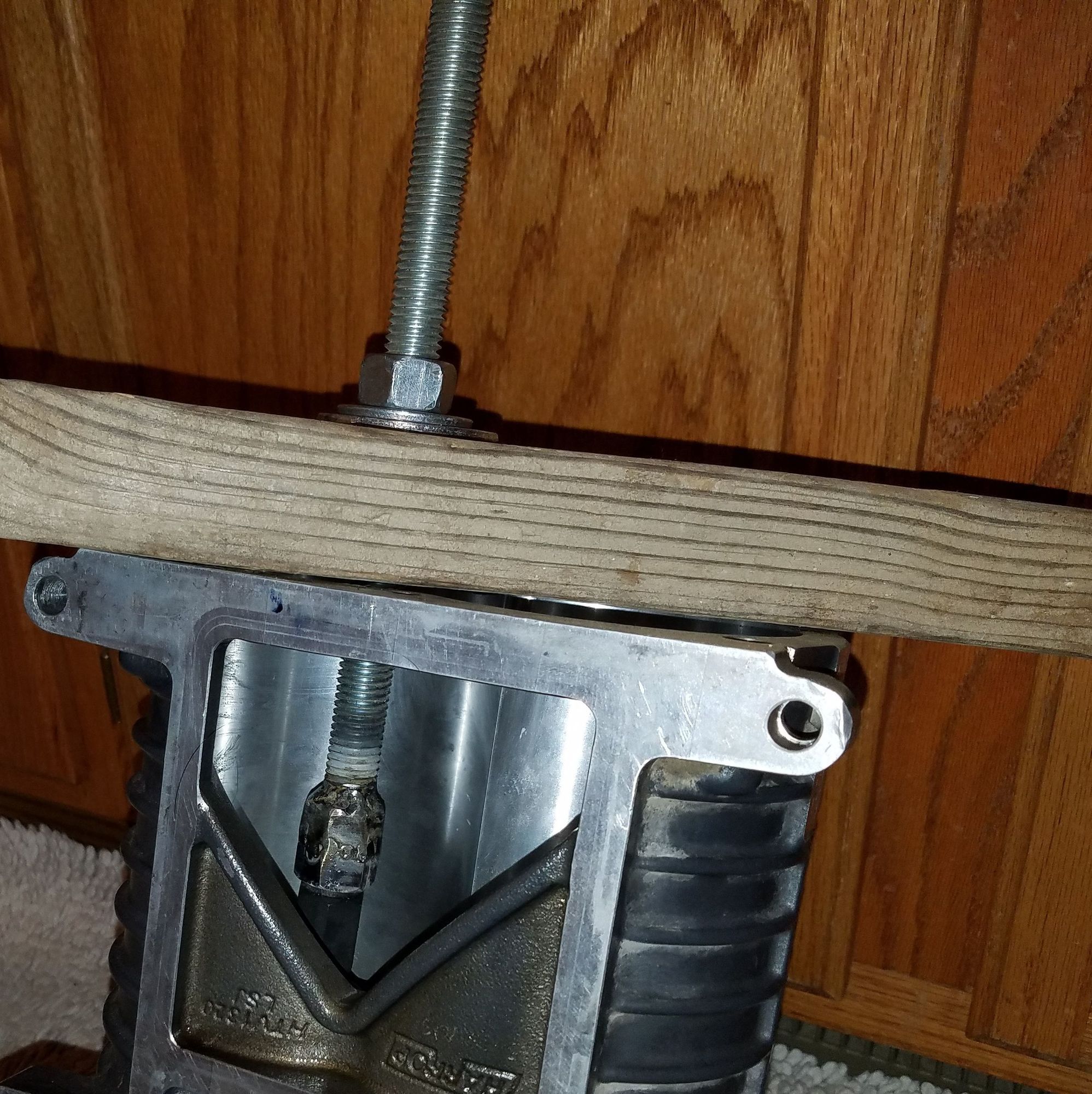

Took two hex nuts with the same thread/size as the end of my blind bore bearing remover head and welded them together and then welded them to a piece of all thread. I used I wood 2x4 to brace against the face and a wrench driving a nut to extract the bearings. The slide hammer that came with the head was not enough to break the bearings loose.
