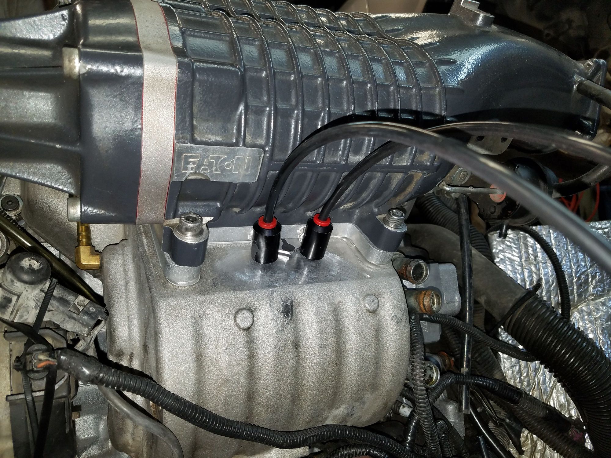

The meth nozzles had barely any clearance with the IM. You can see in the picture I even smoothed out the surface of the IM for more clearance. I have the left nozzle clocked so it doesn't line directly up with rib on SC.
