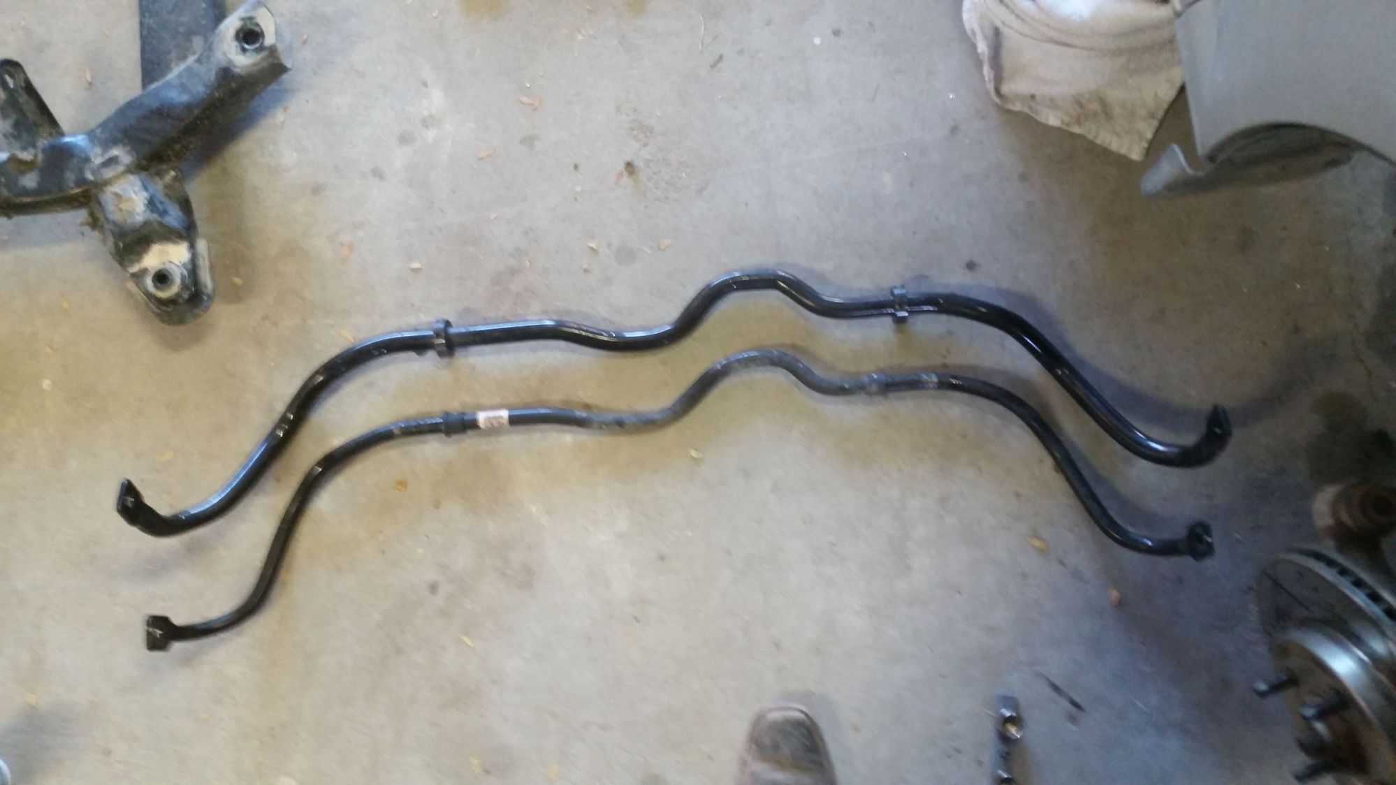

Wish I took a side view to show it better but if you look at the sway bar ends you can see why they need different length end links. The mounting points on the FE5 bar (top) are extended up, closer to the strut housing mounting point, relative to the FE1 bar(bottom).
