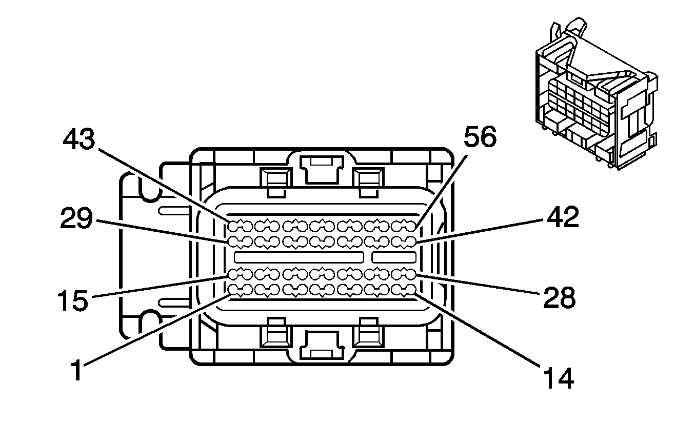

| Table 1: | Powertrain Control Module (PCM) C1 |
| Table 2: | Powertrain Control Module (PCM) C2 |
| Table 3: | Powertrain Control Module (PCM) C3 (M86) |
Connector Part Information |
Pin |
Wire Color |
Circuit No. |
Function | ||||||
