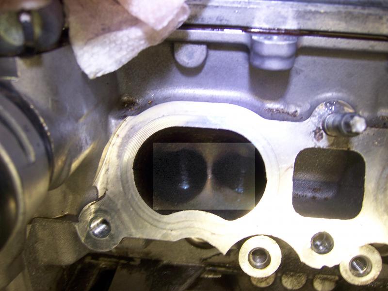

I'm trying to find the picture from MPx showing carbon build up. They didn't seem to think it's an issue, but I think otherwise.
Makes me think seafoaming might be a good idea, but I'm so scared to do it. Don't want to foul the plugs or cause more damage to sensors and such.
Sucks that the 236 code has multiple possible issues associated with it but now we have solutions.
Pretty hard to see, but I've attached a pic of my #1 intake valves at ~50k miles. I tried to lighten it a bit for detail, but they sure aren't shiny. This was after seafoming three times at 15k or so intervals. Def a lot of carbon buildup, meth injection would help a lot.
I ended up cleaning them with solvent and a small brush best I could before putting the mani back on. It's a common problem with direct injected engines.

If the car's running fine chances are your valves are in good shape. I'm questioning if driving the car in the winter, DI motor or not, where clearing out the carbon is a little difficult (I can't exactly hit 21PSI on ice, that's dangerous ) is leading to those of us in colder climates having more issues since I can't call it coincidence when my friend, 15 minutes from my house, had the exact same problem. It's just a thought, I have nothing to back it up, but I suppose it's worth considering .
I just took my intake manifold off for other issues and looked inside only to see valves that looked they they came from a 1960's small block ..
I have pics in my compression test thread..
someone else said the same thing at 50k miles.
Would seafoam help? I've never used the stuff but have heard LOTS of guys bragging it up so I just might try it ..
The dealer we took ours to never asked a single question, warranty was immediately approved. Pretty hard to blame that on anything but the motor itself, especially when the fuel in the tank is 94, the oil has been changed at required intervals, properly serviced, etc .
50k miles is a LOT more than 40,000km, we're talking ~25,000 miles here converting KM to Miles. In any case, it's still a huge hassle. Looks like this is common like I thought, but never found one thread that could break down the symptoms step by step. Mind linking your pics into this thread as well?

More likely to occur on the LNF because the intake valves are always dry with the injector being in the cylinder itself. This was an issue with older VW (I think it was VW and not Toyota) when they started messing with DI motors. It's not impossible for a non-DI motor to experience carbon build-up on the valves, but at least most motors have something flowing past them besides just air since that's the entry point for the fuel as well .

here we have the most definitive result of intake valve deposits in a DI set up!
I think colder weather (Canada) may have exaggerated the problem...but it still lurks in our DI motor! I'm putting on a catch can this week (@25K mi now), but I live in So Cal and don't see COLD. I wonder what kind of gas you guys were using? They say *top tier* gas helps...who knows? I also use a very good fuel system treatment (Redline SI-1) which has the same ingredient as Techron..only more cocentrated. It goes in EVERY tank of gas (3 oz). Yeah..the intakes don't see gas, but this stuff could still linger in the blow by gases and still keep the combustion chamber and injectors clean. Also, I switched to Pennzoil ULTRA at 12K mi..it's supposed to keep the motor very clean (factory clean) and is very good at reducing sludge as well. I don't want to use Seafoam at the point.
