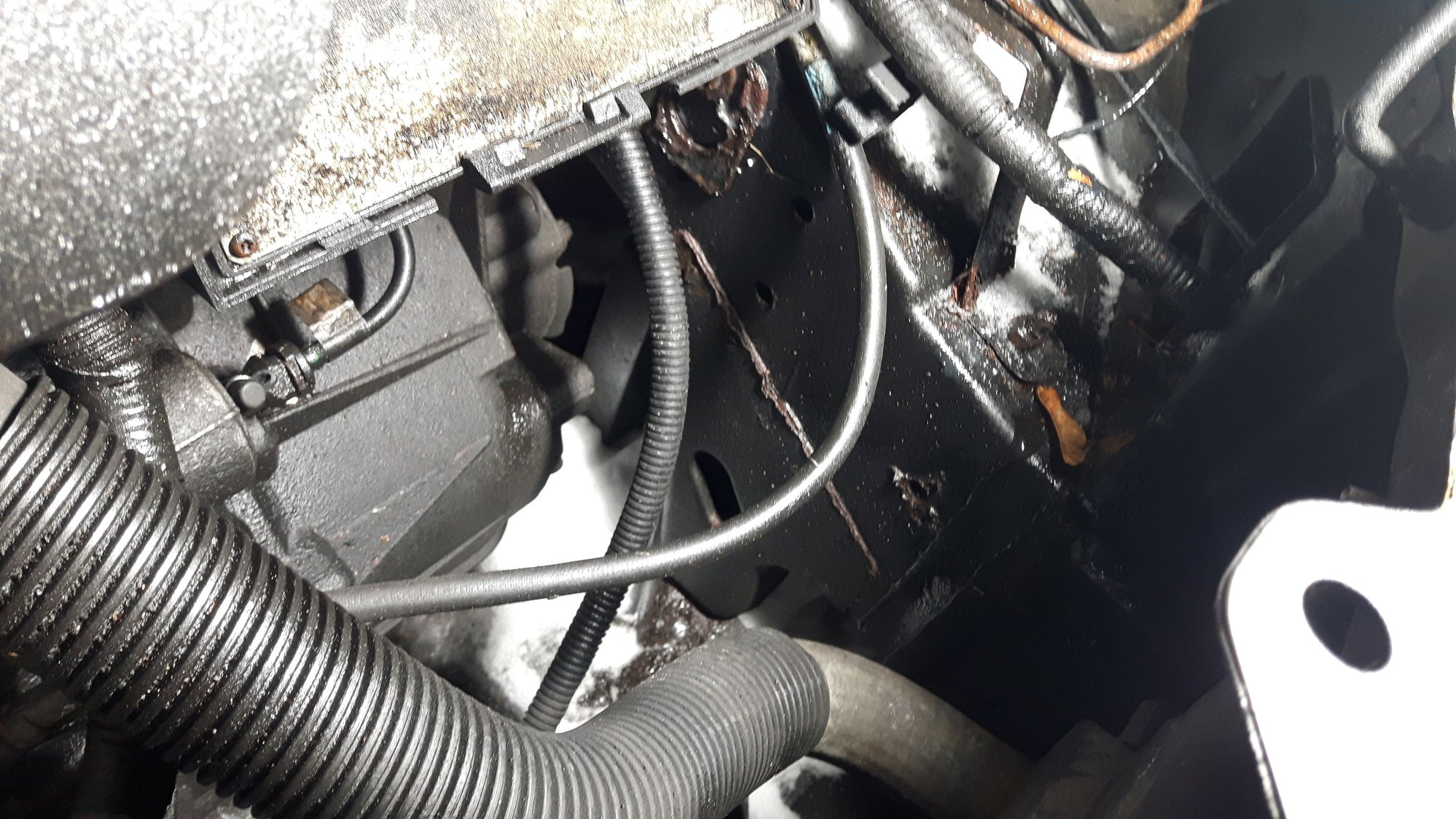

Engine bay

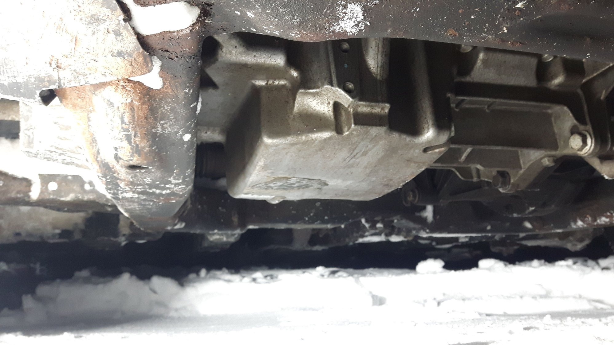

F35

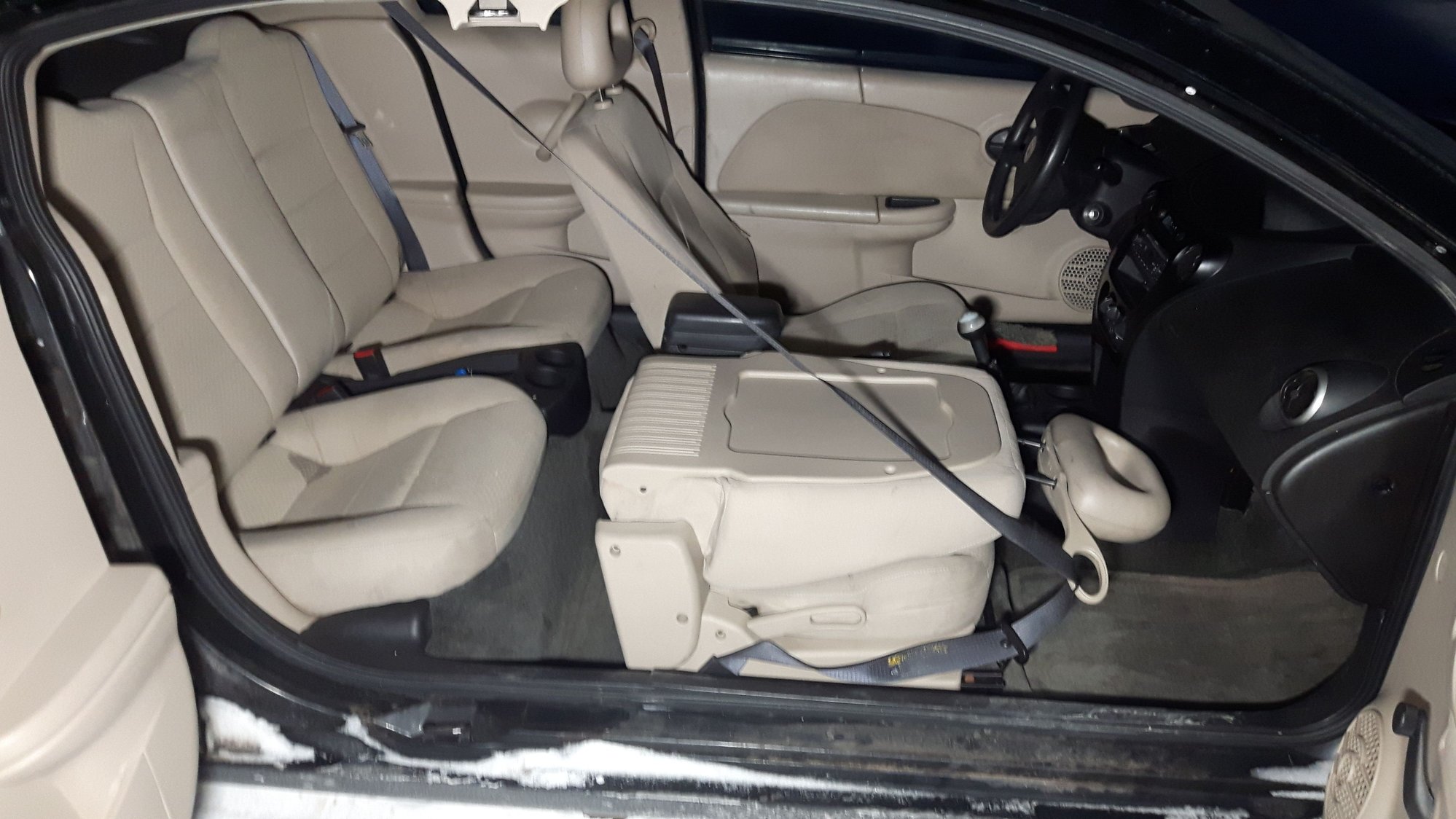

Interior. All panels painted black, Black cloth or SS seats also on shopping list
