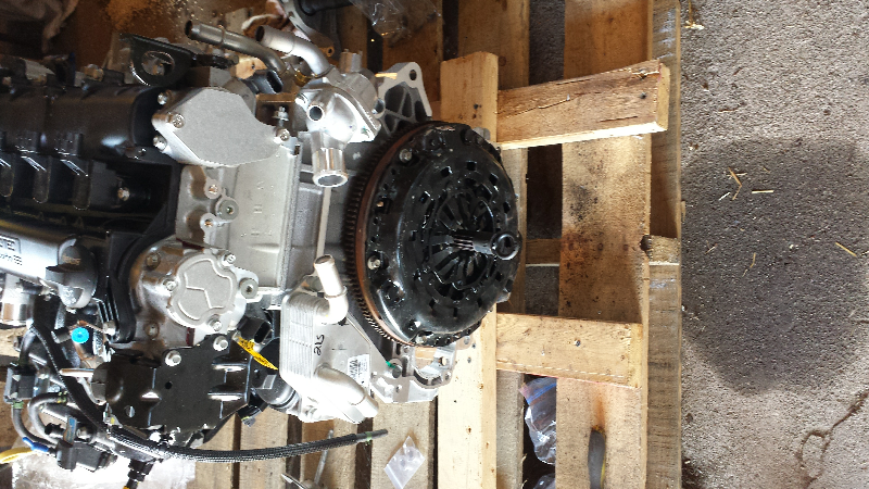

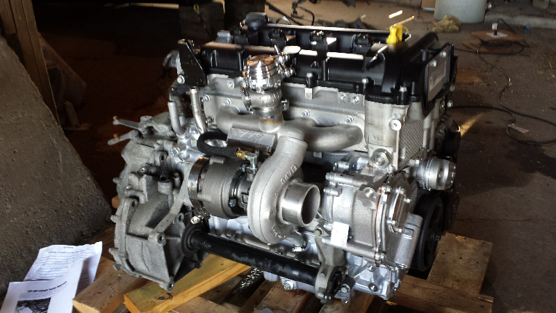

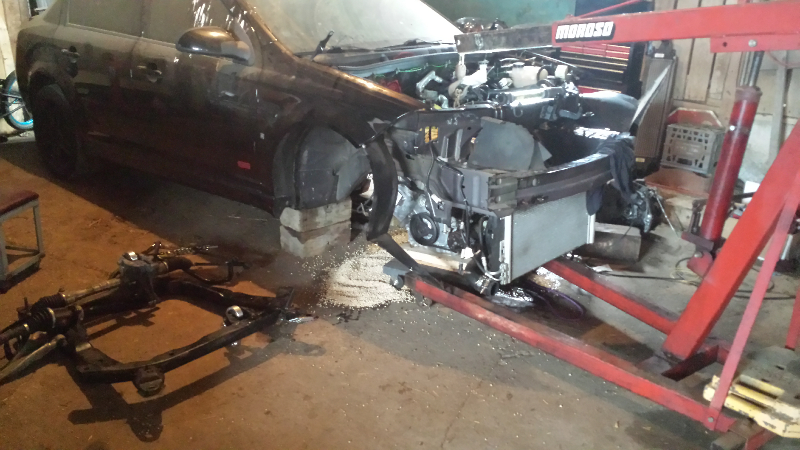

Update its back on the cradle ready for tranny fluid.

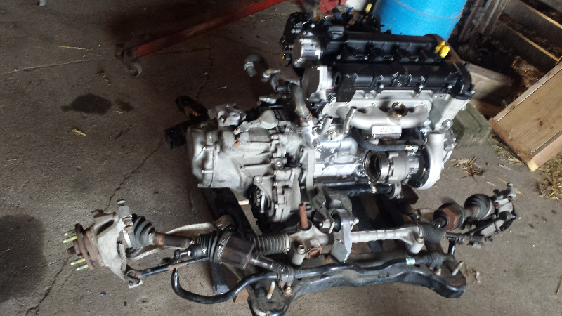

Advice for anyone changing a clutch the TOB has 3 torx bolts on it that WILL 100% strip. Every guide says they are a T30 but they are closer to a T35 and are butter after 60k miles. I stripped all 3. If you do strip the. My best way of getting them out was tack welding an old hex key wrench to the tops and twisting them out then breaking the bolt off. Everything else went peachy.

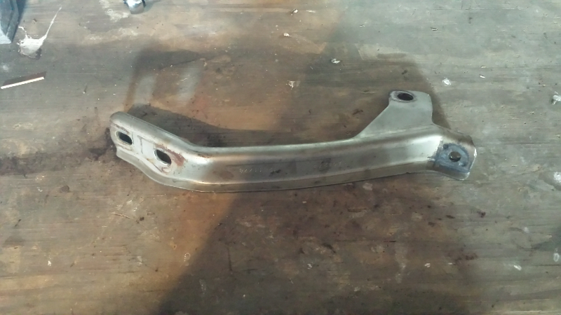

Any idea what this is or if it even goes to our cars? It was in the pile of parts my mechanic gave me after he tore the head off... is it the turbo brace? Trying to figure out if it goes back on or not

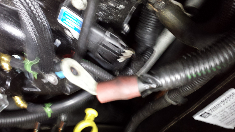

HELP!! There are 2 hot wires that connect to the fuse box red jumper spot the one goes back to the battery and the other hooks to something in the engine bay. Where does that second one hook? I can't remember where it hooks to from the fuse box. does it go to the top bolt on the starter?

Got it all hooked up ready to go, started her got her purring like a beaut... go to bleed the clutch and after 50 pedal pushes clutch fluid starts rolling out the bottom of my trans while bleeding the slave...
I am guessing the banjo on the TOB isn't tight enough or secured enough... so I get to yank the trans out the side since everything is hooked up to it already.
Pissin me off, about ready to drag it to a mech and say here you fix the clutch.
Edit: TOB was bad, fluid pours out the back side of it. It was a green TOB which I have read a decent amount of others have been having problems with.

I am beyond pissed off right now. Got the TOB when I got home from work. I installed it torqued it down and got ready to put the trans back in. The side pull method is a crock of ****. My dad and I were both wrangling the trans to get it back in and something would not align up to save our lives. So now I have the cradle off the engine lowered because I can't unhook the fuel line and the transmission is sitting next to the car.

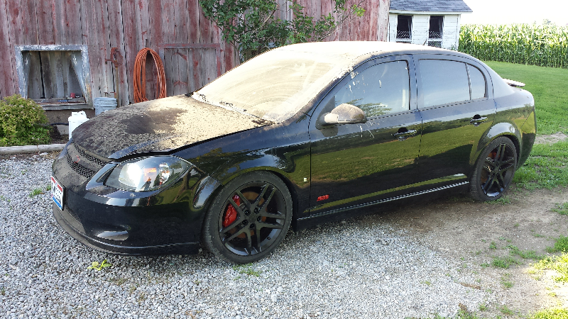

Brought her out for some fresh air today she sounds mighty fine no knock, missfires, or anything else while I rolled her around. Having a problem with the brakes though. Figured out I put the brembos on the wrong sides. (Bleeders are facing down) and I am not keeping brake pressure on the first push so I'm gonna put her back up on ramps tomorrow and switch around the brembos and attempt to bleed them again. She looks good all lowered, almost couldn't get the jack out from under until I did the 2x4 under the wheel trick. Also gave her a bath right after this. Birds did a number all over it while it was in the barn for so long.
Old Jun 30, 2014 | 08:31 PM
  #164
crashher0's Avatar
Joined: 06-20-13
Posts: 507
OK washed her up, got the brake issue figured out. Drove it down the road about 1/4 of a mile and back and when i got back it had a little bit of smoke coming out of the tailpipe at idle then when I tapped the gas it would blow a little more and oil pressure would bounce around between 60-80 psi.
Is it just oil from the engine being broke in or is oil getting by or something? Its a brand new LDK first half mile on it today.

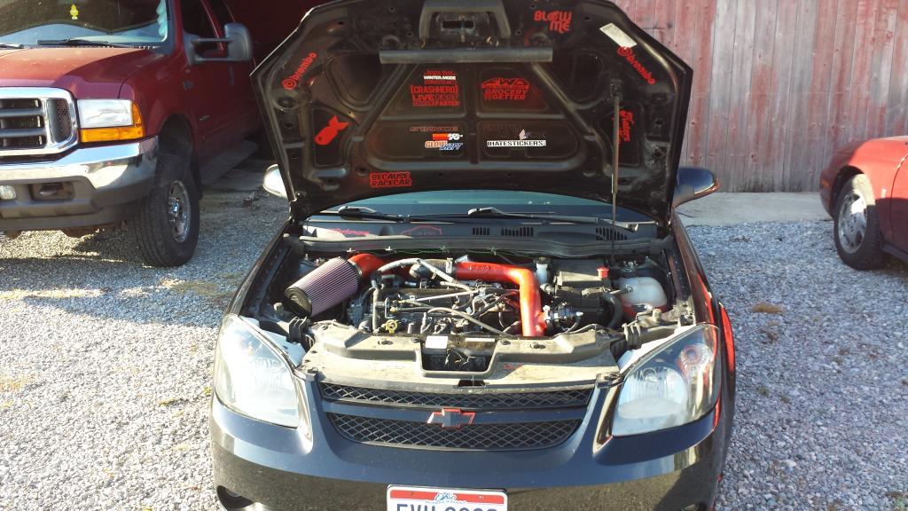

Update pics: All cleaned up, updated the sticker collection. Removed the injen, trifecta and added a few of parts I added.

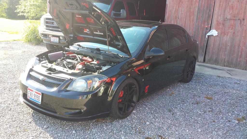

Havent posted in a while so i figured I would give an update, Car is running great! almost 1000 miles on it. Going to get the AC re filled today. Have yet to get it tuned but have just changed jobs and moved states so thats been put on hold for a while still. It starts up rough because of the maf relocation but after it warms up it runs very nice. 3-5lbs of boost is nice but makes me want to get it tuned and see what this 256LDK combo can really do,
Stance SS coilovers have been tuned by my buddy and it rides great, my girlfriend thinks it rides rough but I think it ides great for coils.

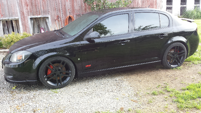

smoke has gone away except when it starts up and burbles and coughs a bit then its good.
