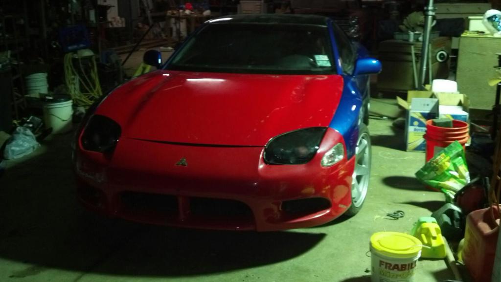

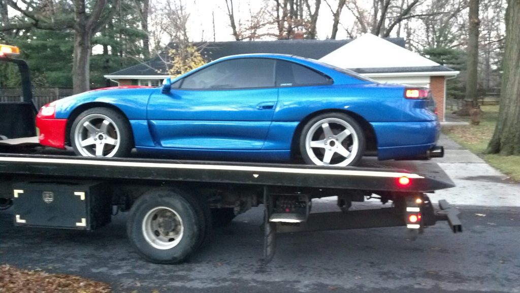

The single shot is going to be replaced by the IPS quad tip.

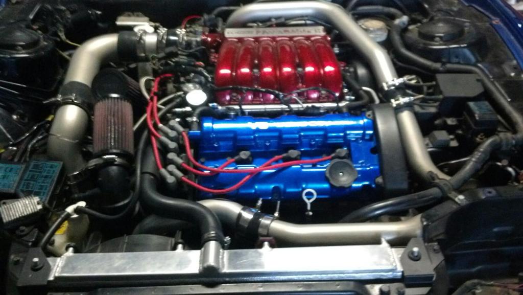

That's how it sits right now. Engine bay has been cleaned up and organized more.
