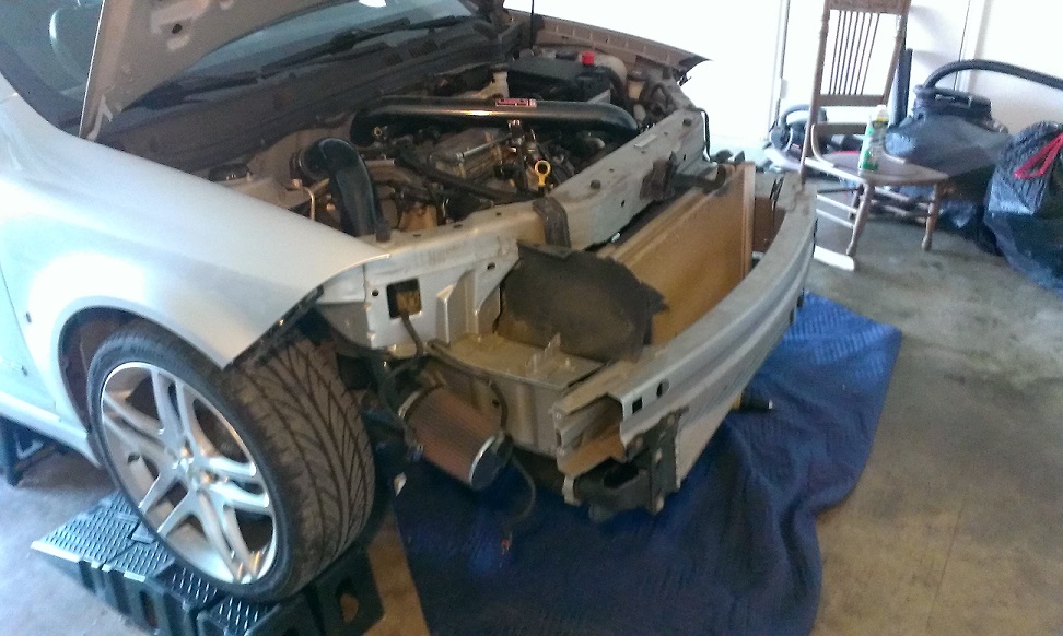

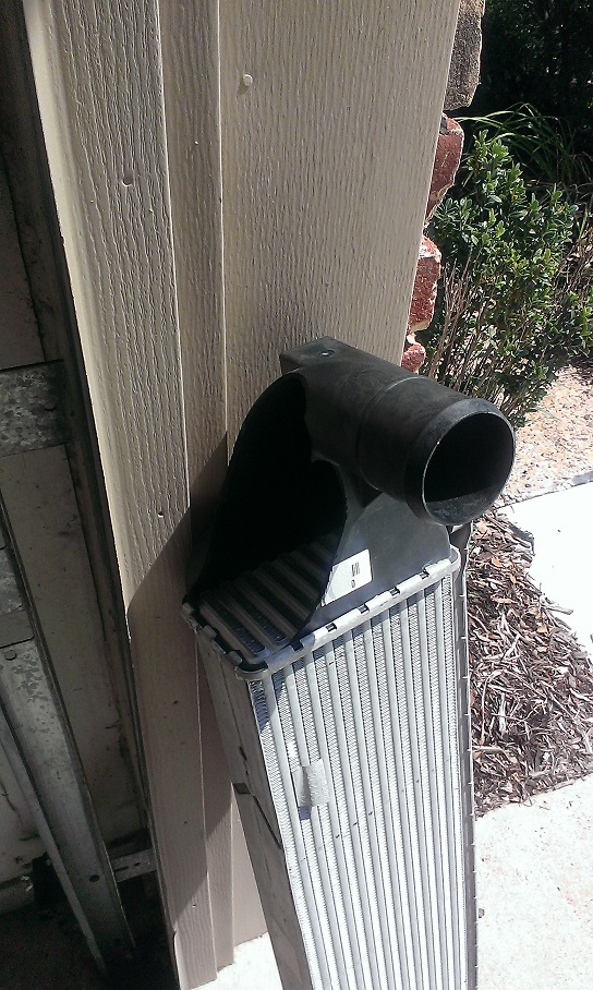

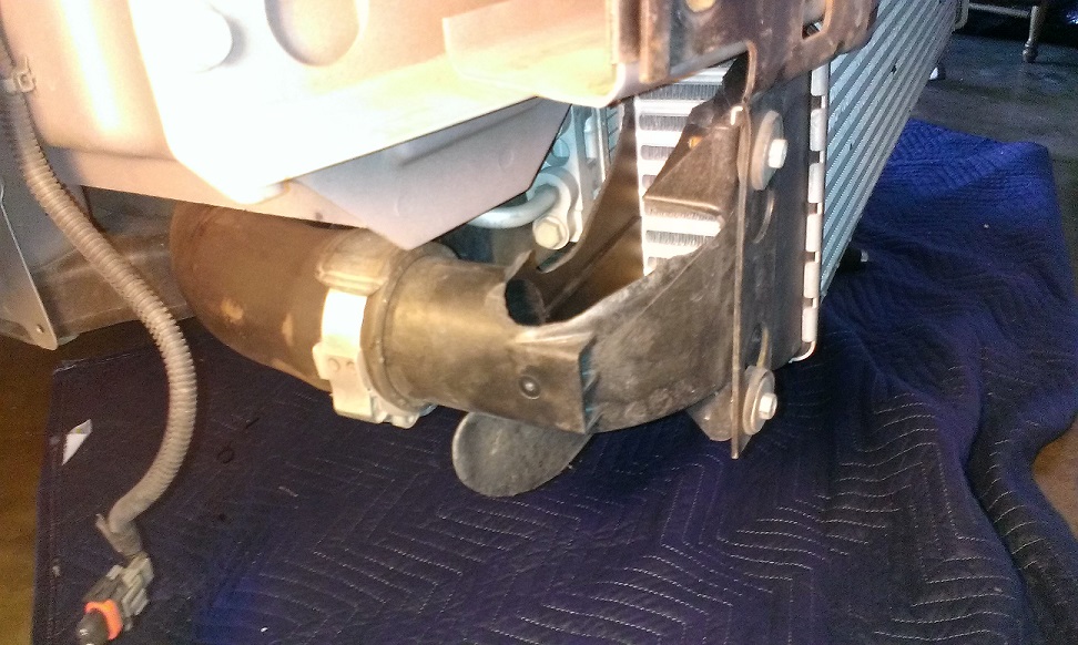

09 TC with MPx full exhaust, Hahn intake, Injen hot side piping, Trifecta tune for power mods.
I heard a loud POP while under what I'd guess is no more than 50% throttle. I experienced an immediate loss of boost, but an otherwise drive-able car for the 10 minutes it took for me to drive home. I figured I popped a connector which is exactly what it sounded like. However all the hoses seemed in place after a brief inspection.
I threw MAF malfunction codes, P0100 and P0102.
After I parked the car would not idle or run at all for more than 10 seconds. The RPMs would rise and fall over and over until it stalled. Removing the MAF led to a stable idle condition but it would run extremely rich.
Despite the massive damage to the end tank I could not feel or see it from under the car. I wasted time looking everywhere else before I finally just removed the bumper (messing with the wastegate a lot due to the TSB that somewhat described the condition I was having). I was shocked when I finally saw it.
I immediately ordered an MPx replacement due to cost and location (takes one day to get to me).

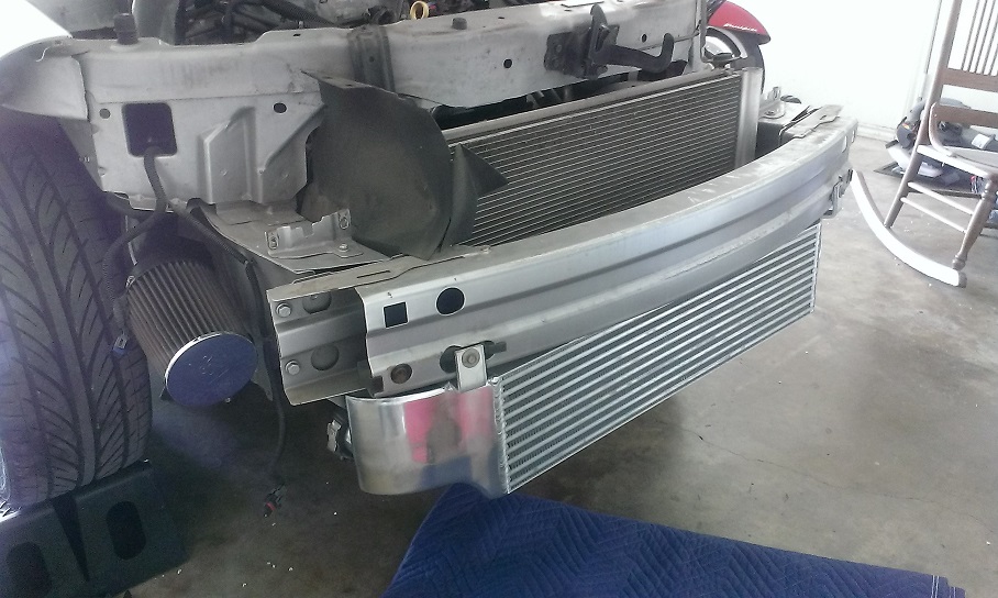

All better. The fit isn't 100% with the undercarriage plastic covers. It is minor enough that I didn't feel like making the trims on the fins that would make it fit. The downside is that 4 screws are unable to line up with the bumper and plastic cover (2 on each side) but it seems to have zero effect on the rigidity of it so I don't think I'll bother.
On a weird side note - when I installed the MPx exhaust I broke the old O2 sensor. Since then I just left it out since I thought it only measured the effectiveness of the cat which I no longer had. The car ran fine. However right after I installed the new intercooler the car would run awesome, then go into limp mode, then awesome, then limp mode over and over again. I threw a P0036 code which basically is a result of it just being missing. But I figured since it ran fine beforehand that something else must be up.
I hooked up a new O2 and the car runs perfect. ??? Why now? Then it got weirder. Before I was running exactly 20 psi at peak. After I put in the O2 sensor I run 23 now. Hooray! But...? I just don't know.
After all that I'm still throwing a P0100 code for MAF circuit malfunction. I replaced the MAF for good measure since I wanted to anyway but it's still happening. Since that was the same code I threw when I had what was essentially a (massive) leak, maybe it's still a leak. I don't know maybe somebody here has an idea.
I basically wanted to write this so people could see how the car behaved with a blown endtank and the codes given and whatnot!
