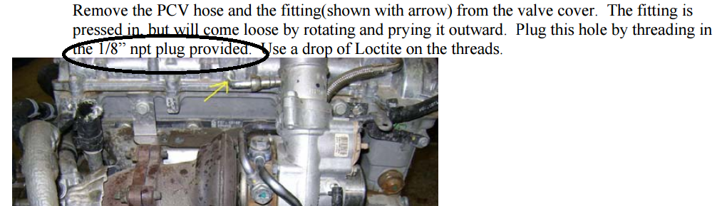

1.Using the zzp lnf big turbo how to as a guide. He noticed that they stated to plug the hole with a 1/8 npt plug. Seeing that he piece together his kit, he does not have this plug. Is this plug supplied with the lnf oil feed return kit that zzp provide?

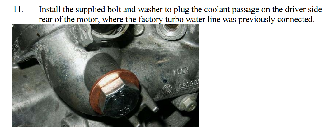

2. What size bolt does he need to plug the coolant passage?

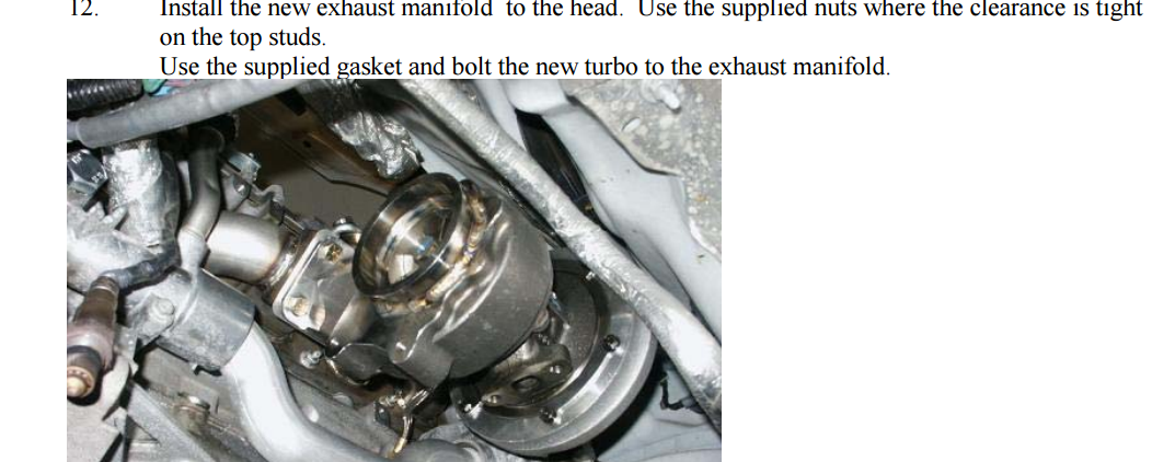

3.Seeing that he got the s257sxe what will be the best method to bolt the turbo on to the mani?

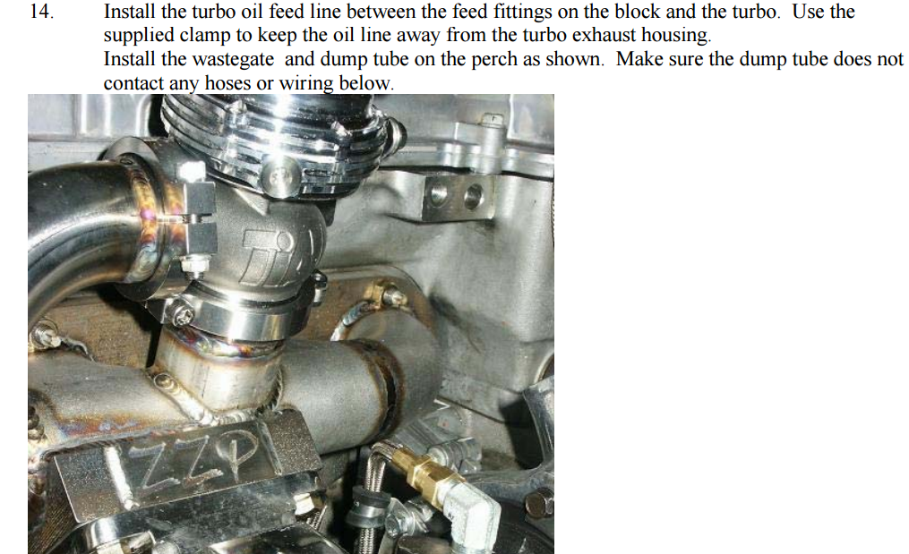

4. Is the clamp stated in zzp how to required?

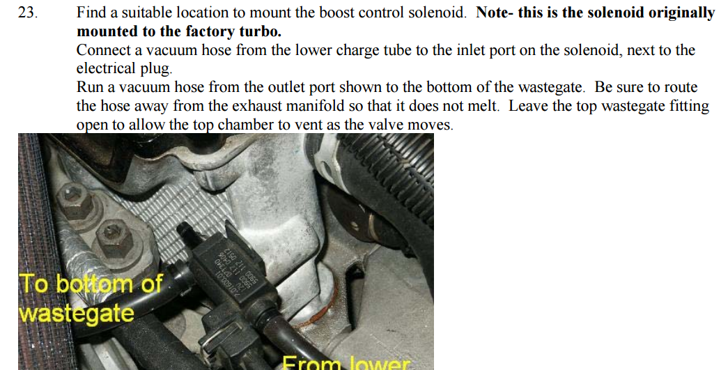

5.Best place to mount the boost solenoid? Also will he need longer vacuum hoses?

What? Why do they want u to plug the pcv port. How is ur crank case supposed to get fresh air
i have no idea. Do i not need to do that step for a big turbo setup?

email them and ask them, for my setup I'm removing the fitting in there valve cover, cause it gets in the way of the wastegate, and I put a 90 degree 3/8 barb fitting, which lets u run the line to the intake.
