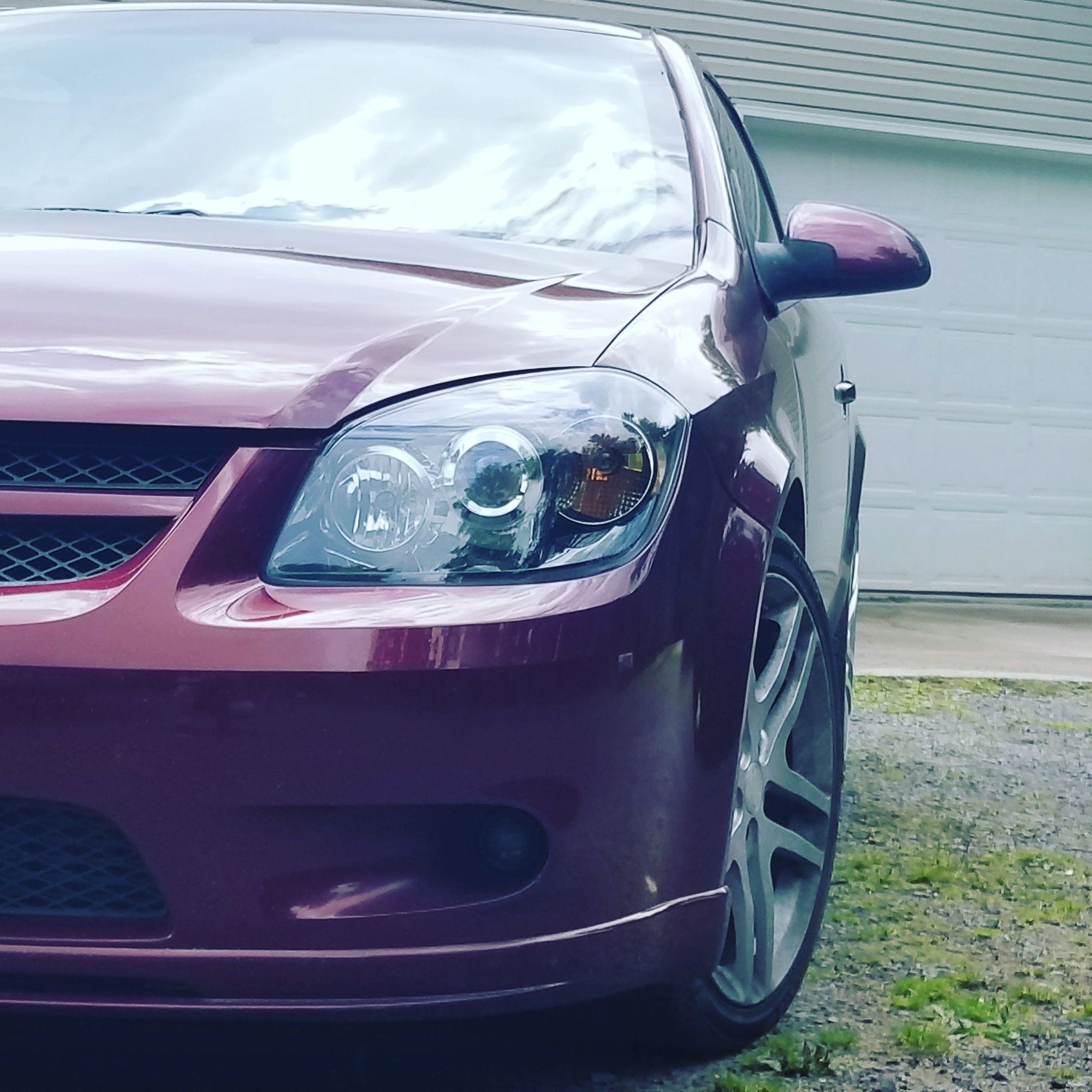

Put these puppies in yesterday and I cannot stop looking at them, I love em!

I just unplugged my ballasts and plugged the bulbs that came with the gen 4s in. Not sure if i'm gonna buy HID H7s or not
