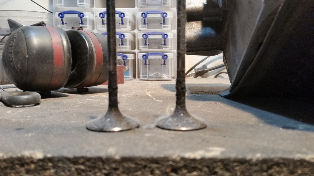

OK guys I finally pulled apart my old cyl head with about 60k miles on it. For those who do not know me I bought my car new had it fully bolted and tuned after the 1st oil change and it has grown from there. After maybe 2 to 3 years I threw on a meth kit. I ran washer fluid for the first couple of years but then when I switched to the K04r I started mixing my own and ran a high meth %. I have seen way worse valves than mine on other cars I have worked on and the head that is on my car now had double the build up to mine.

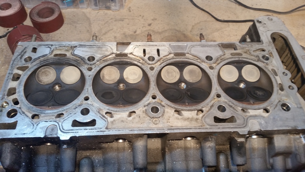

Here is a pic of my combustion chamber from the head just weeks after I did my dyno

Originally Posted by ae_xiong
Quick question, how about e-47? Any cleaning benefits involved there at all or not enough ethanol to do anything besides for HP gains?
No E47 will not clean the valves. Running meth or a 5th changes the intake manifold from a dry to a wet type so the fuel passing by the valve cleans it. Our DI injector shoots into the cyl not the port so no fuel hits the backside of the valve cleaning it on the stock fuel system.

those valves don't look to bad at all. and dang the combustion chamber is clean. ill keep running my meth.

when my meth was hooked up spraying 1000cc nozzle it was so clean that i could perfectly read the manufacturing numbers with my inspection scope
