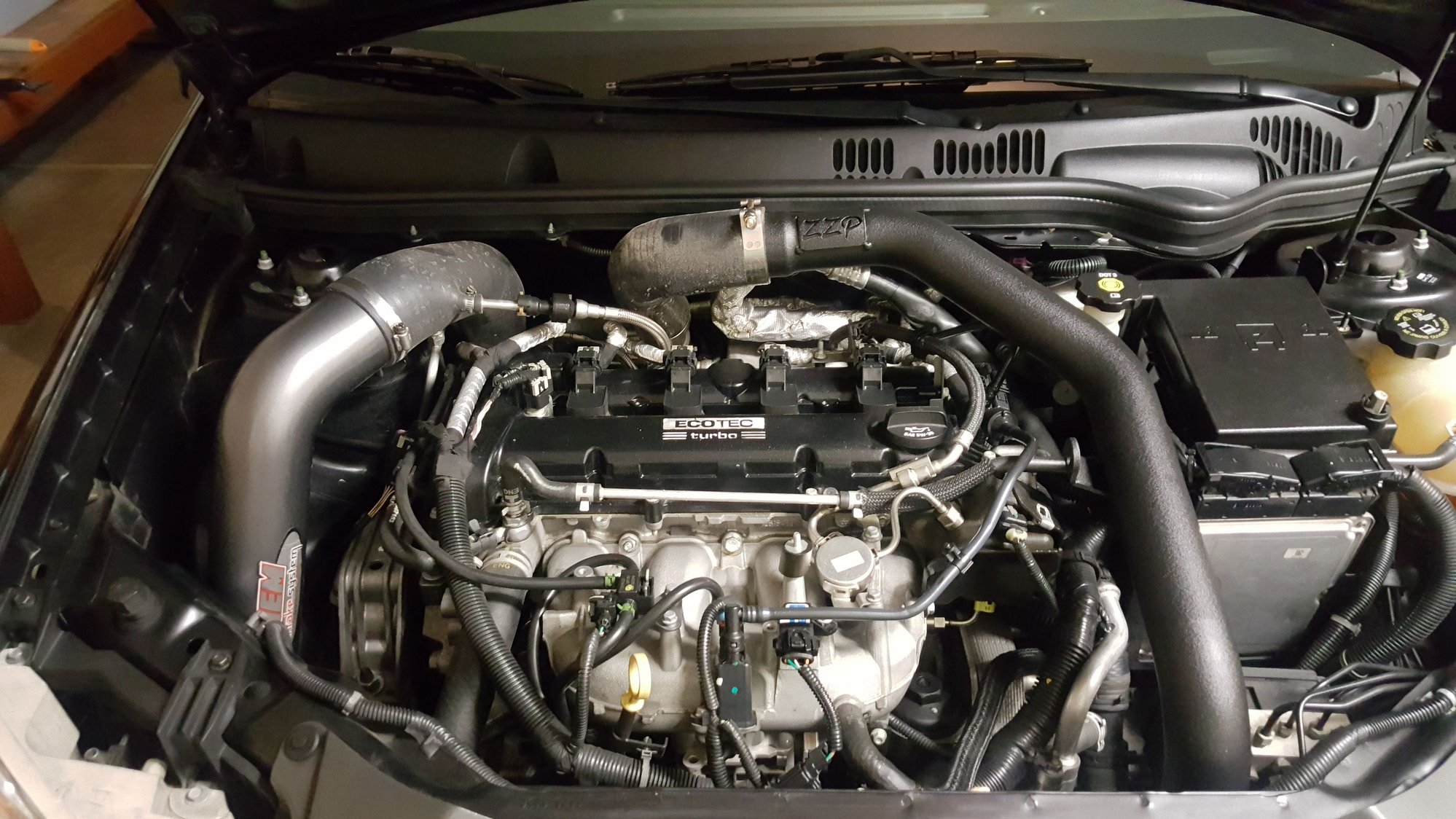

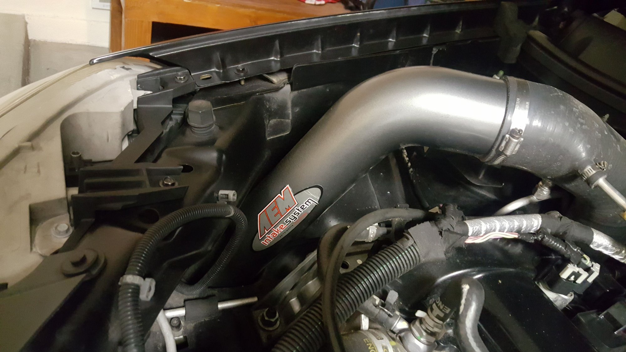

Hey guys..The way I wrote it, I may have been confusing. The cruise control issue is not causing the intake issue..The mechanic at the place I bought it from hooked it up to the computer and it kicked out some Cruise Control errors where the car thinks its on but it is not. He said he is going to fix this. He also said he took it to the Chevy dealership who then told them about the intake issue causing it run rich. I am actually going to run down to Autozone right now and get it read and I'll let you know the codes.
Also, here is a picture of the intake.

Old Nov 7, 2016 | 08:09 PM
Gotta say thats the first time I've witnessed a LHU hot side charge pipe on a cobalt
lol I knew something looked off about that engine bay
Old Nov 7, 2016 | 10:41 PM
tomj77's Avatar
Joined: 07-14-08
Posts: 12,039
Likes: 156
From: canada
Originally Posted by brettxw
Is that good or bad?
the upper charge pipe is ment for the lhu in the regal, its bent to fit regal engine bay. the lnf one is just a 90 degree bend higher up. if it works, its fine

From: Battle Creek, MI
Anyone else notice it has a 3bar map? I wonder what the state of the engine tune is like.
Old Nov 8, 2016 | 06:45 AM
Nice catch. And since I was looking closer there, notice the injen hot side mounting bracket still in the intake?
Given the rich code I wonder if the previous owner traded it in while it was tuned for e47 or e85
You bring up a very good point. The LHU charge pipe makes me think the owner rushed to get the car put back together before selling.
You need to confirm exactly what is done to the car. Does it have the stock intercooler behind the bumper? What tune is on the car?
If it were me, I'd find someone with HPTuners in your area. Shouldn't be too hard. I 'd flash the car to GM Stage 1 or have the car logged and get a real tune for that intake.
Again, you need to start by finding out what you are dealing with.
And for the love of god don't beat on the car until you figure it out. If it's tuned for E47-E85 then you are risking blowing the ringlands runining that rich.
