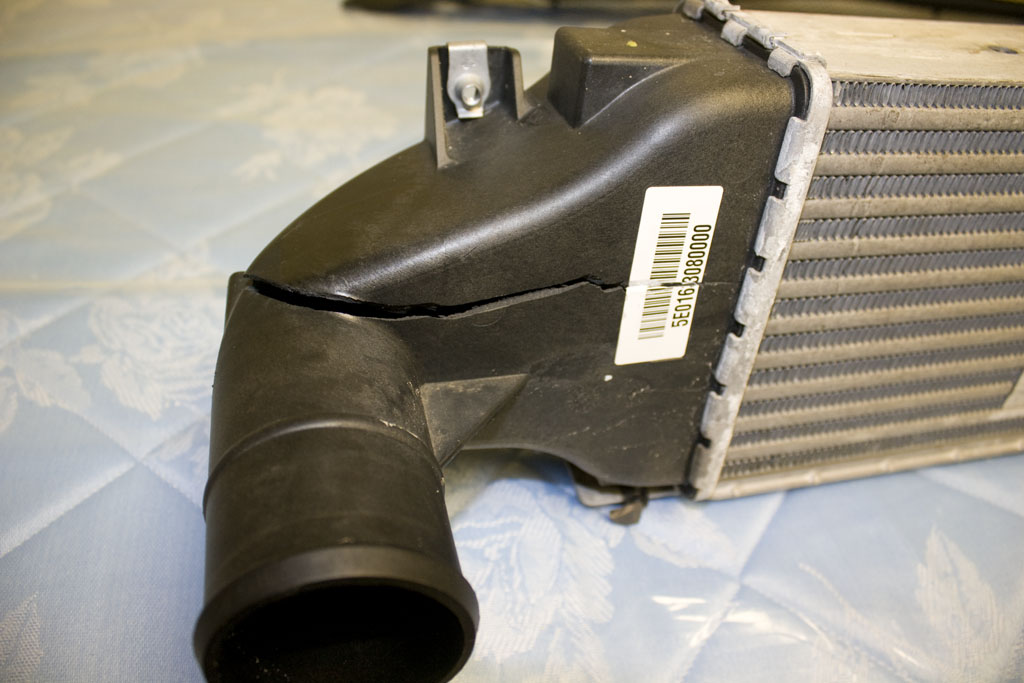

Here's a pic of the end tank damage, at the condenser tube, if anyone is interested.

tape to fix a boost leak? Now I really think you have a boost leak.
If you hit the intercooler enough to break the tabs you could have easily done damage elsewhere.
I would remove the bumper and do a boost test and check everywhere on the intercooler.
A small leak will throw a P0101

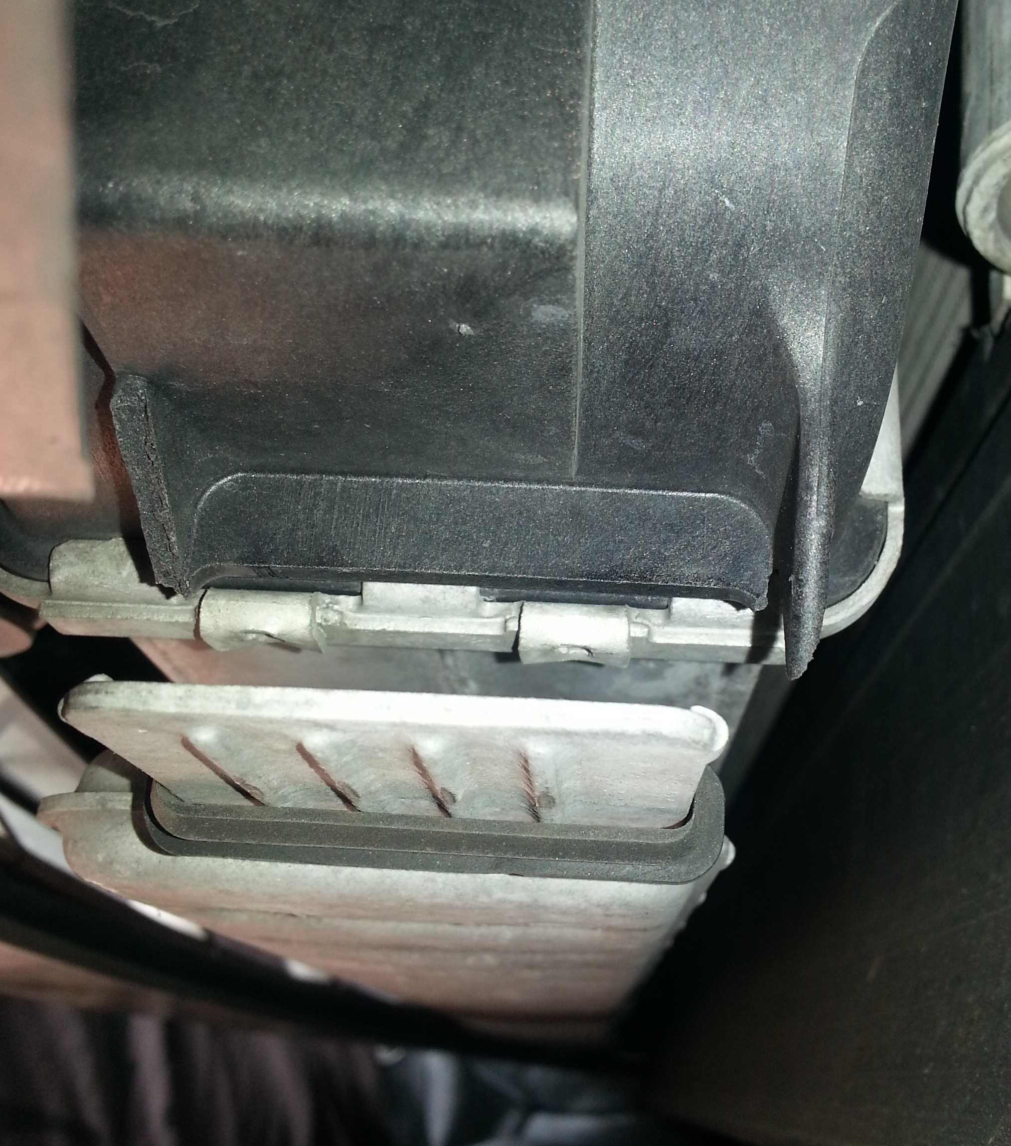

take the bumper off and check the whole intercooler out.

The tape/tie was to remount the drivers side of the condenser tube to stop it from moving and causing a leak on the pass. side where it actually connects to the IC. There was no obvious crack in the tank and no leaks when boost leak tested, after that fix. But yeah I'll be taking it apart in the next 3 months or so.
