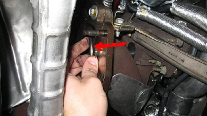

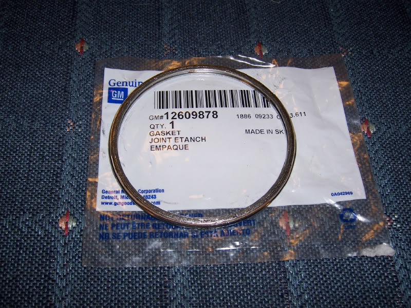

Chicken's right: that is the wideband O2 sensor, but it's odd that it happened right after you put in a downpipe. Sounds like a serious exhaust leak. Did you replace the crush-gasket when you did the DP? If not, are you sure the old one was still in there?

Have you figured this out, OP? I just replaced my crush-gasket this week when I put my ZZP DP catted-DP back on. I removed it for inspection and noticed a small area around the DP flange where there was some soot. I definitely had a small exhaust leak from using the same gasket too many times. I had no code, though.
