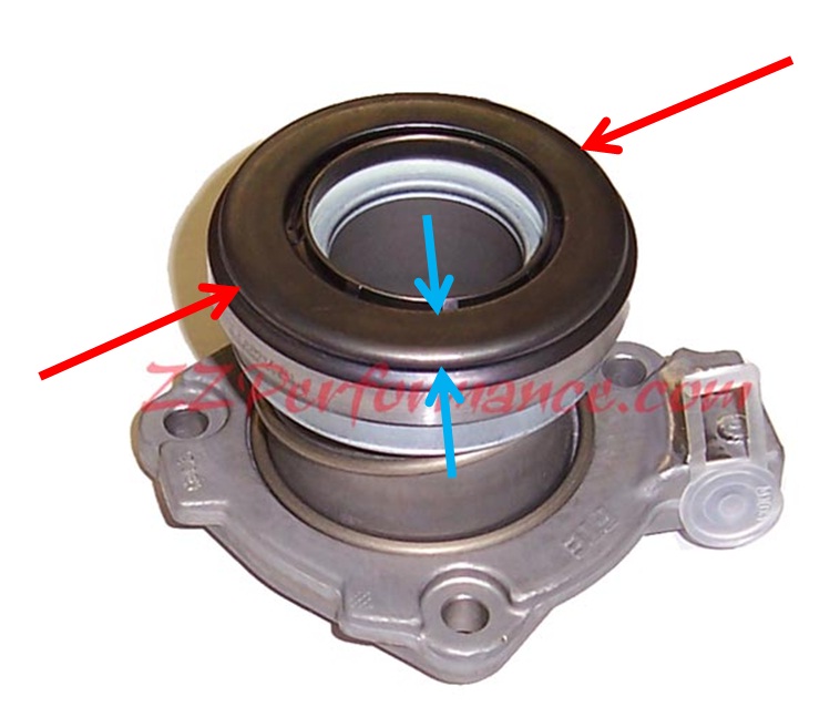

Gents,
I'm trying to use a different transmission with the LDK and need to know the throw out bearing contact diameter. Can someone with a pressure plate and/or throw out bearing measure the contact diameter between these two parts?
Thanks,
Daniel

I believe I have both of those in a box at home I shall check , but explain what contact diameter is a little for someone who doesn't know much about clutchs lol

Hi, I just mean the diameter where the throw out bearing makes contact with the clutch.

2 3/8 inch

Thank you. Just to be sure I understand you, that is the middle of the contact area? What is the approximate radial distance of the contact...1/4"

That's from edge to edge of the contact area across the tob. The actual contact area part is about 1/4 inch yes. I can send u my old tob if u want. For price of shipping

Just to try to make sure I understand you clearly....
Red Arrows = 2-3/8"
Blue Arrows = 1/4"
right?

Yup, the blue arrows is actually about 3/8 but since it rounds down the actual contact area is about 1/4 inch , but Ya I send it so u can make sure. Pm ur address and I'll let u know how
Much for shipping.
