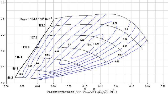

If you've got specs or some other map for ours that are "correct", then post them up by all means. This is what I found when I went out looking for the flavor of k04 used in the LNF.
I'd be happy to do the flow conversions to whatever people post up as well.

This is the map I saved like a year ago, I think BTF had posted it on one of the Kappa forums. See how it calculates out if you're bored!

Here's the compressor map with the conversion:
If this is actually ours, then it makes the one I originally posted look optimistic.
That is not our compressor map. The first one you posted is correct. There is only one K-04 that flows more than ours and it has the wheel the BTF uses in his conversion kits. The big wheel K-04 flows 3-4 lbs/min more than ours at 37-40 lbs/min at 22-24 psi vs our at 33-36lbs/min at 22-24 psi. Corrected flow on my logs consistantly shows 33-34 lbs/min at 22 psi and 35-36 lbs/min at 24 psi.
If I would have the correct compressor map and be sure about it I would share it for the LNF community. But I don't have it and I hate to base on not confirmed information.
Not having the clearly correct one doesn't mean we should get first one which we find and state this is the one.
Terminator check tuned Audi S3 8P, that is more potent turbo than ours and is still a K04.
Old Jun 5, 2010 | 07:46 PM
Stamina's Avatar
Joined: 02-09-09
Posts: 4,374
From: Tejas
To my knowledge, it was the correct one. That's why I posted it. I didn't post it because it was any old k04 map.
To what I said earlier: I'm open to me making a mistake on something, and if you had what you thought was the correct one, that clearly needs to be posted up for everybody's benefit and I'd be happy to admit my mistake.
On the wheel size topic: I seem to remember BTF stating that we had the 3rd largest. There was ours, another one (possibly this Audi A3 one Kelu mentioned... wasn't said in BTF's original post), and then the k04+ wheel.
