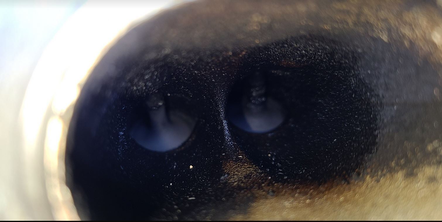

Originally Posted by ProfDNS
....but what I highly recommend is getting the valves walnut blasted to clean them up
+1 on that and the PCV and Cloyes timing set.
This was done with the cheapo HF blaster. I've used this on a couple DI engines and it's always amazing how well it works.

@blacksaleen95
1). How many miles did you have on your car when you took the pic?
2). Which media blaster did you buy from HF? I've been trying to figure that out. (Do you have a pic if you don't have a model?)
3). Did you buy any specific attachment to cover each intake so you can feed in the blasters and vacuum at the same time?

Originally Posted by carcar12321
@blacksaleen95
@carcar12321
1) ~210k I'm the 2nd owner, I don't believe it's ever been done previously.
2) 50lb'r https://www.harborfreight.com/portab...rtable+blaster (course walnut media))
3) I didn't bc the engine was out and I was lazy...however I rigged something when I did this on my LFX using a piece of plywood with a hole cut in it for a piece of pvc pipe, used a coupler to connect that to my shopvac and positioned it so it covered half the port so could blast the other port. I made it so i could flip it to do the other side of the port. I'd show you a picture if I could find it but I think it got tossed when I moved. My suggestion is to get some plastic and use that to cover everything around the intake, and tape it off if doing it in car...use compressed air to blow out the port when done, and before you blast use long thin-blade screwdriver to lightly scrape the larger carbon deposits on the valve stem... everything else comes off pretty easily. I also added a piece of ~1/4 tubing to the front of my blaster held on with some hose so I could direct the blast media a bit better.
