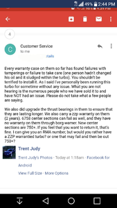

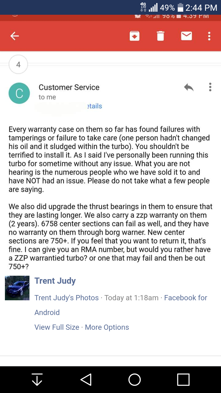

So, just to give some info for the failures.
ZZP had told me they had issues with the BPV spring being too stiff, causing issues with fluttering and surge.. They are busy now saying this....so which is it, or are either of the statements true?

That's a bold statement
Old Feb 7, 2018 | 05:35 PM
I wonder if he means caking on the turbo shaft not sludge. Also thats crazy to think they claim tampering, the **** you tamper with a center section on a turbo you just bought unless you're a competitor and then why in the hell would you think of warrantying it after.
Old Feb 7, 2018 | 06:43 PM
Sharkey's Avatar
Joined: 10-27-07
Posts: 5,681
Likes: 266
From: Abbotsford BC
by tampering they likely mean adjusting the wastegate or changing the bypass valve.
Old Feb 7, 2018 | 07:28 PM
slapbetcommissioner's Avatar
Joined: 09-15-09
Posts: 4,140
Likes: 57
From: Winnipeg
So if I read that correctly they will either give you your money back or they will rebuild the core for 750$? How does that make sense? So get a refund and buy a new one?
Old Feb 7, 2018 | 07:41 PM
Tdubbs's Avatar
Joined: 09-18-15
Posts: 748
Likes: 96
From: Battle Creek, MI
I think that's what they offered them, but I'm not sure as I'm not the person from the pic. I was just going more with the fact they told me they had some issues with the bpv causing surge, but they're telling people who ask about the failures that they were all user caused issues.
